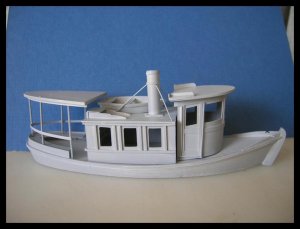

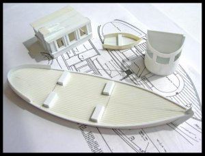

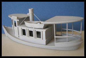

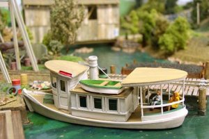

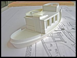

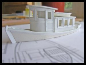

This is my first submission to the Hobby Forum. I would like to share a recent project in HO scale for a Maine style river steam boat. I started with plans from a large scale magazine and reduced them dowm using Photoshop Elements and printing them out on my home printer. The hull was made as a water line model. I began with a block of balsa and attached a paper pattern to the top of the block showing the hull outline from the top down and also attached a paper pattern to one side showing a hull profile. I used a scroll saw with a tilting table to first cut the top pattern and then the side profile. After "LOTS" of sanding and balsa wood sealer, wet and dry paper and many coats of paint I had a hull. The hull was used for a pattern to cut the deck, oversized and sanded to a final size. The pilot house was layed out flat on thin styrene and bent around a jig to get the correct shape. Passenger area was plain straight forward flat construction. The stern area open deck does not show yet but will be covered with a wood deck, railings and seats for passenger comfort.
