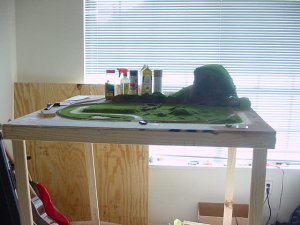

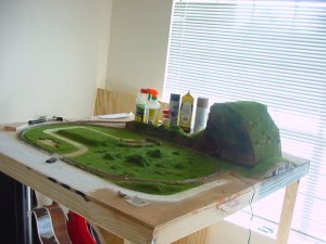

Say man I live in a very small apartment and I chose N scale over ho for this reason and you can cover more ground with N as opposed to Ho. I cut a 4x8 sheet in half and made a loop with a father loop. I now wish I would have made an L shaped layout but this works good.
Choose wisly

If room is the problem I would go with N-scale. As you can see Joe has a nice railroad in the making in a small space. You can even go micro like Tyson did. Check out his beautiful 1x2 layout in the N&Z scale forum.
