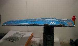

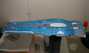

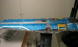

This is a WIP model of the Hiigaran battleship from Homeworld 2. I have had a few issues with building this model, mostly with the various pieces of the ship fitting together.

It looks like yours is going together better than mine did. I have a slight warp and twist in the bow area. I also only built one of the gun turrets, too tiny and complex for my fat fingers. Still an impressive model when finished, though. I'm looking forward to seeing yours when its done.

Warping certainly has been a bit of an issue with the pieces not fitting together right. I think I can straighten most of it out as long as I can bend it enough and apply some super glue in the right places.
