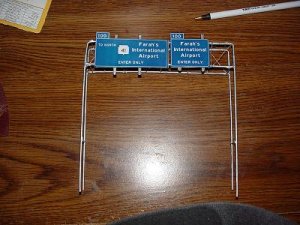

xtcrr
Feb 7, 2006
19
60
I think im going to go with the small copper pipes bent, yeah i saw where you fit stuff in side the tube to bend it, sounds simple but does it work in real life.....time to find out!
Taylor
Dec 24, 2005
22
50
I never thought I would find a street sign so fascinating. That think looks awesome and is very similar to the ones in my area. Great Job!!!
