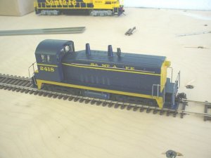

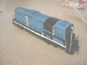

Well Ray, I bought some junkers, paid anywhere from $2 to $12 bucks each, fiddled around with them, took them all apart, cleaned them, put them back together, mostly just using it as a learning experience. Great stuff.

#2418 looks like an Athearn, those don't need a lot to make them great. If it has the original Athearn drive with the original steel sliders, you can do a lot to improve them by just hardwiring the connections. Go to www.trainweb.org/ocmr/ Click on "links to member pages" and then click on "Jim Furhman's home page" and if you look at his contents page you will see "Tuning up Athearn and other ho locomotives." Click on it and he gives instructions on how to make an Athearn run like it has a can motor. By the way, used Athearn drives are readily available at train shows and swap meets. They make a great drive system to use with bodies from toy locomotives like Tyco, old Bachmann, Life Like, and Model Power. If you want an Rs 11 Alco for instance, nobody that I know of ever made a good one in plastic, but one can be built using the body from one of the many cheap toys and an Athearn drive with GE "B" trucks.
