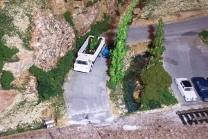

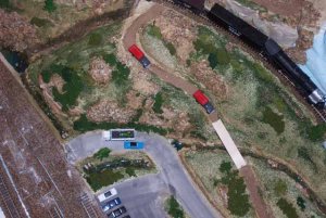

I'll try to get'cha a closer up of this area. It starts out as runoff coming from two culverts underneath the upper tracks. It then cuts itself a little ravine which will travel under the future bridge of the mining road. It then runs off into a little pool area before crossing underneath the paved road via two more culverts. It then cuts in between the road and the parking lot. Before the railyard was built, this lonely little creek used to continue straight on but now, it has been diverted under the road again in a hard left via 2 more culverts where it drains down next to the rail yard and joins up with the runoff from the mine. In the second picture, as you mentioned, you can barely see 3 sets of culverts. In the fourth picture, toward the very bottom, you can see where it comes out of the culverts and runs along the edge of the railyard. Like I said, let me see if I can get'cha some closeups. My camera does not do those real well but I'll try. I have to wait until tomorrow though when I can open the window blinds to get some natural light and not have to use the flash.
TrainNut
Ditat Deus
Well, I pulled out the 'ol tripod and took some flash shots and they did not turn out too bad so here they are. These scenes are not finished by a long shot. The roads will receive at least one more (if not two or three), darker color of grey. Also, where the road seems to dead end into the yard, after the track of the yard gets laid, the road will continue on across at that point. That big ol' pine tree right there in front... I think that's gonna have to go. It is too distracting. Oh, and obviously, the nice pretty piece of flat wood (part of a tongue depressor) is only pretending to be a bridge until the real one gets built.
