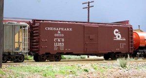

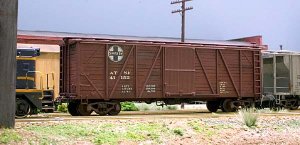

Here are two of my boxcars. The first is my scratchbuilt 40' wood boxcar, the second is a 1937 40' AAR boxcar made by Red caboose.

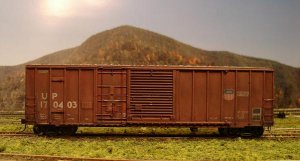

Wayne, Tom and Kurt:wave:, FANTASTIC CARS! posted on this page!!!:thumb::D. well guys, i am going to test the waters here;)tooth1. this thread was started by Catt(awesome idea Catt:thumb: ), and titled "freight car of the week". i propose we call it "freight car of the day", and post ANY freight car;)tooth1. i think it would make for an AWESOME thread of a multitude of different freight:thumb: . ANY thoughts on this? Catt, if i am WAY off on this, i am sorry, and WILL delete this post. tooth1 -Deano View attachment 29427

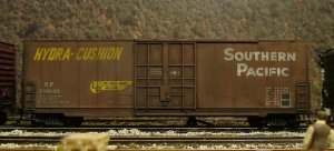

Slightly upgraded LifeLike Thrall Alldoor boxcar from the 1970s.
Mods are ,1 Athearn trucks with Jay-Bee wheelsets,2 bodymounted KaDee #58 couplers,3 new stirrups to replace the way to thick plastic ones.4 colour matching the end ladders (they were black).
I am planning to replace the ladders with freestanding ones in future.

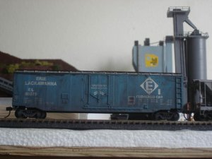

Do you think this old Milwaukee Road box spent some time in its nameske cities industrial valley?

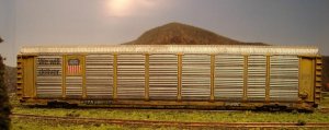

Here's another boxcar from Train Miniature. This one started out as a plugdoor car: the door operating mechanism was shaved off, along with the tackboard that was to the left of it, then new, cut apart and re-assembled Athearn doors were cemented over the area. The existing door track was modified for the new, narrower main door, then a similar track was constructed for the half-door. The cast-on steps and grabs were replaced with metal parts, and the overly thick stock roofwalk was shaved down using an autobody file. I didn't bother with underbody detail on this one, but perhaps at a later date.:D Paint and weathering is Floquil, as usual, and the lettering is a combination of Champ decals and C-D-S dry transfers.
