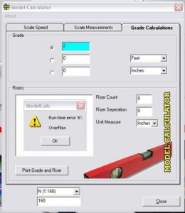

Will, Thanks for replying. I've searched and searched, for anything on 3d Canvas. Looks like it was at one time installed on your computer??? Then when it was uninstalled it took with it a part of the graphics back end that is built into windows, and is one of the graphic drivers VB needs to operate. Now when VB tries to use that part of the graphics system, all XP knows is that 3d canvas is where it got it from the last time. According to Microsoft, you should (and only if you feel like it) do a repair of XP to get the file back.

Still looking, here's replys from the Microsoft Newgroups, to my question. Both replies go down the same path I did. As aside, the screen shot you sent me had some pretty cool graphics on it. Where'd they come from? Also, do you know anything about the 3dCanvas application? I've been hunting the web for info on it, and it (3d canvas) is a pretty common phrase.
"SKMoss" <SKMoss@discussions.microsoft.com> wrote in message
news:AB05A0D8-8B55-434D-BCA4-2EFEAF4A87DE@microsoft.com...
> Getting an error on running a vb6 program. The user is getting
an attempt to load something from 3dCanvas.msi. Any ideas.
Nothing comes up on MSDN. The only control loaded on the program
is the tab control. Rest is vanilla VB.
> Steve
Windows does that some times for seemingly no good reason. I've
had a time where every time I would try and load VB, the Front
Page installer would try to activate. The only way I was able to
get rid of it was to allow the installer to complete
(fortunately, I had front page) Generally, when these kinds of
issues appear you can just keep clicking cancel and eventually
the app will run fine, but I've yet to find what causes the
problem in the first place.
Andrew Faust
And a second reply
Adding to Andrew's reply, the Windows Installer service is detecting
something missing in the installation of that program. It may be a
missing reg entry, file, folder, component, whatever.
<theory>If your app happens to be using a dll that's marked as 'Shared'
and some other app's using that same dll, the Windows Installer service
will attempt to make sure all dependancies are available to both
apps.</theory>
The best way to deal with it is to let the repair finish its work.

Well, after reading about 3D Canvas, I thought I would DL it and install it as it is freeware.
After I did that, Model Calc loaded, but the first calculation I entered, I got the following...
Sorry, Steve, my conclusion is that Model Calc is not ready for public consumption. I do not think it is a good policy to have "customers" beta test your product. That is what your friends are for.
My suggestion would be to go back and do some more tests and come back when Model Calc is stable and does not need other products installed to work.

Will,
You won't get any arguments from me on beta testing. It's been through a lot. But it's a freeware program, and the folks helping me test it have been just like you. Model Railroaders interested in helping out the hobby. There not professional QA folks, just folks willing to try to help.
I appreciate the help you've been so far. I'm working out a couple of other issues with the program. I should post a support page later today with fixes to the app. I'll post here when I do.
Again, Thanks for attempting to get the program running.
Steve
