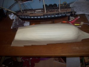

    I continued on the upper works adding plastic body filler then made the spar deck.

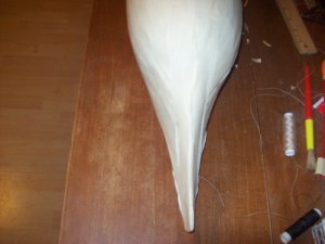

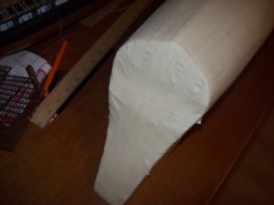

    I have coated the model in several coats of masking tape then coated that in car wax hopefully this will act as a mold release.

    She's starting to look fine. When I saw the first wavy pictures I didn't expect to see the hull in that shape.
    However, and it's weird nobody has mentioned this before, I think you might have mis interpretid the plans regarding the beakhead. In ships of that period, the beakhead was portruding from the hull, and not part of the hull itself as seen on your model.

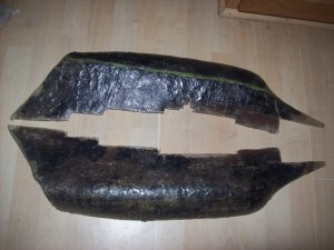

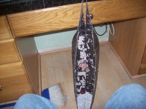

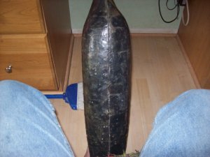

    I have completed the mold unfortunately the mold release that I used instead of tape did not work and the plug had to be destroyed to get it out of the mold. I am now waiting for some better mold release.
    pics. (Note: I have smothed the inside and filled the gaps since I took these pics)
