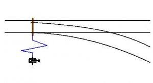

I use the Caboose Groundthrows. The ones without the built in "spring" i take a piece of piano wire and make a "Z" pattern in it and set it so it puts pressure on either direction that it is thrown.
Caboose ground throws are what I used. (Earlier I mistakenly said Chooch Industries.) They always worked well but the N Scale throws were way out of scale and required giant LPB's to operate.
