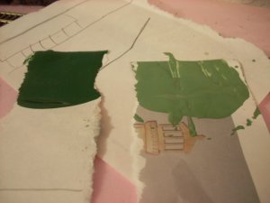

Here are two options after I ran out of tan, what looks better? Also, what would look better behind a tree line to give the impression that the trees go deeper into the woods?
puddlejumper
Dec 7, 2007
254
Southern Maryland
I like the left one. I don't know how dry your climate is, during late summer here my yard looks more like the one on the right.
For deeper appearing forests I would go with a darker ground color to simulate the shadowy nature of lots of tree cover.
