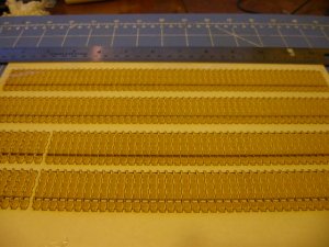

    parts first glance
    here is a break down of the kit parts having all arrived at HQ

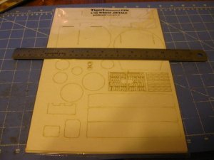

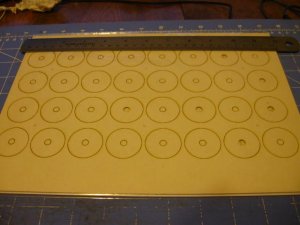

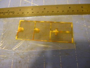

    more kit parts

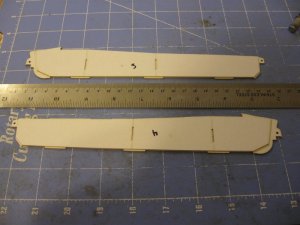

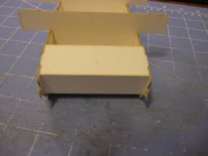

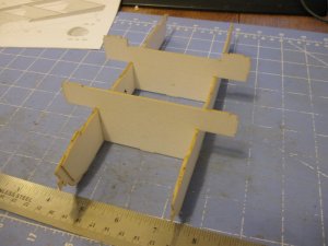

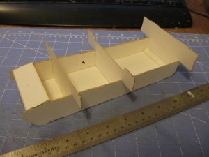

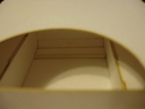

    building the tiger tank internal frame
    well so it begins.
    we start at page one, and assemble the frame.
    i consider the optional former kit money well spent, no longer do i have to worry that the model will assemble true and square, and it is a great relief to my broken hands lol...
    i am very excited to build this model so lets begin...
    and thanks gpm for making this kit!

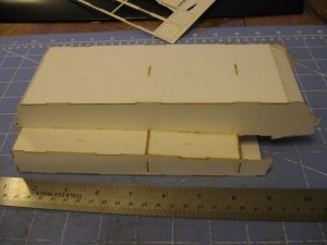

  8. The Hermit
    The Hermit Member
    Jul 29, 2007
    143

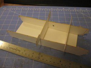

    more tiger frame work madness
    well this is approx 1.5 inches of the instructions complete! :twisted:
    lol looks like lots more major funness to go....
    photos continue

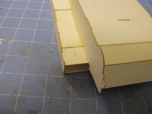

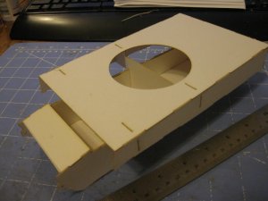

  9. The Hermit
    The Hermit Member
    Jul 29, 2007
    143
    the fit on the formers is quite good,
    even so you do have to bevel the edges where they meet on angle,
    if you keep that in mind the fit is perfect
    i dont see it as a issue but a design limitation with the laser cutter since it cannot cut the formers on angle but only vertically
    enjoy :thumb:

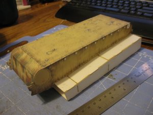

    143

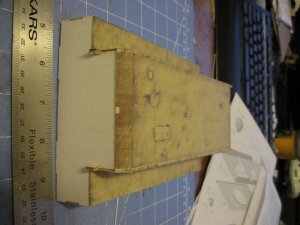

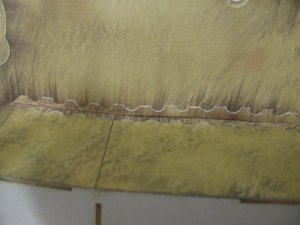

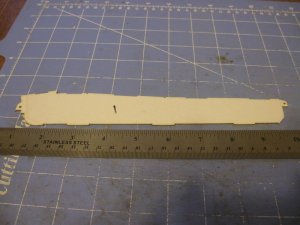

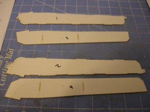

    FINALLY SOME SKIN WORK!!
    i was initialy scared to start this kit.
    i really am thinking i was worrying too much i think it will come along nicely
    i wish i would make a spring lift system like patero did but i dont think im in that league,,, sign1
    that guy can make some model huh?

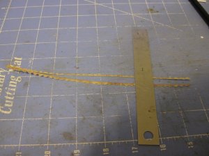

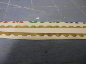

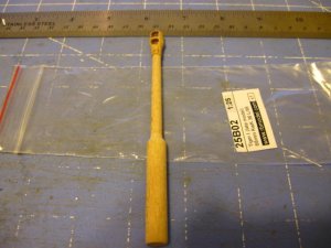

  15. The Hermit
    The Hermit Member
    Jul 29, 2007
    143

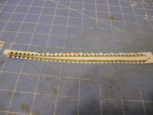

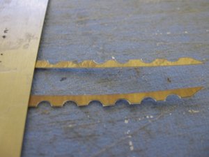

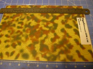

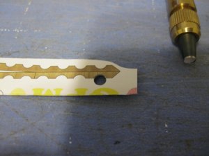

    im working on parts that previously would have made me skeerd heh
    having said that i know now this model is going to push me,
    the following pieces are so delicate that its scary, and i am grate full i bought that darn chinese punch drill off ebay, there is no way i could have cut this as well as it came with out it... worth every penny paid for!!
    i really have no idea what the piece represents (any one know) but i was amazed how it turned out, it looks great... :thumb:

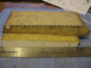

  16. The Hermit
    The Hermit Member
    Jul 29, 2007
    143

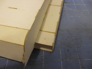

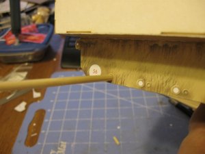

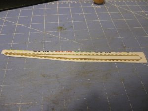

    and finally assembled on the underside of the tank tread well
  17. charliec
    charliec Active Member
    Jan 19, 2004
    395
    It looks like the GPM Tiger may suffer from the same problem as the Halinski one does. The attachment points of the swing arms rely on a small glued area to support the swing arm and the roadwheels. This doesn't work in the Halinski and probably won't for the GPM. I'd suggest devising an alternate attachment method - perhaps a 2-3 mm pin through the hull side might fix the problem. Jim Nunn came up with a solution for his Halinski Panther - comments Jim?
    If you have to drill holes in the hull it would be easier now rather than later in the build.
    Regards,
    Charlie
  18. The Hermit
    The Hermit Member
    Jul 29, 2007
    143
    very keen observation,
    i think i will do as you suggest and use some bamboo rods i have for th 3mm pins
    tyvm
  19. The Hermit
    The Hermit Member
    Jul 29, 2007
    143
    Damn charlie, im going to have to thank you 2x :thumb:
    that is going to work superbly i tested a hole mount in the tiger (thank you chinese punch drill) and the bamboo rod is going to be a much superior mount for the whole kit, i was thinking i would just run it like a axel but they are off se, but im still going to run it all the way across then super glue the log in place, im sure kitty will be able to stand on the finished assembly once completed... sign1
    much kudos for pointing this out and having such a great suggestion.
    again thank you x2 !!!
  20. charliec
    Jan 19, 2004
    395
    If you're adopting this solution I'd suggest making up a couple of strips of 1+mm card with locating holes for the torsion bars (bamboo dowels) and glue them on the inside of the hull so that you can ensure the swing arms will sit square on the hull. You might be able to just glue the dowels on the inside of the hull but it will be very hard to get the swing arms square. This is important because the roadweel axle has got to be parallel to the torsion bar or the roadwheels won't sit square on the tracks. Any small misalignment of the swing arm gets amplified by the roadwheel axle. I'm only making approximate sense - it's getting late here.
    Regards,
    Charlie
