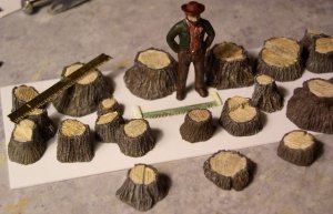

Freds computer ribbon cable as saw blades. Thanks for sending them Fred!

Guys, This is a quick easy project that I made in about 2 hours
The basic idea is to first make a curved convex piece like the prototype blade out of flatbrass. Thin stuff that can be cut with an exacto knife. Basically I use the Paulsen-Knudsen blade as a guide from Jons signature template. Shrunk it down to o-scale. Went out to the garage and looked at the real one I had. Measured it. Five feet long. Then take that (connector) blade looking thing that Fred sent today and rip it close to the edge of the teeth with the dremel tool without destroying the look of the thingie. Then take the thingie pieces and glue (CA) them on to the stock along the curvature of the blade. I glued it all down to a piece of plastic that can serve as a tool shadow board if the molding fail. The two handles are .025 plastic rod notched & hammered. Where the new teeth marry with the stock I filled it with the old green puddy and then sanded it flush. The last step was picking the excess puddy out of the teeth.
glad its done

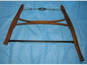

Hey Philip, try making one of these with a cut down blade. That's a great idea, cutting them down with a dremel. Fred
P
philip
what is it..........
Thanks Val.
Fred , Is that one of those old prototype cord saws? I have never seen one of those. What is it? Odd looking tension system?
F
Fred_M
That's a bucksaw Philip. The turnbuckle at the top tensions the blade. These were very common to cut firewood and delimb before chainsaws. This example has finer teeth than most, most were of the type like the two man saw that you built first. Fred
