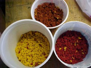

These were a little too intense for me, so I cut each color with some burnt green by mixing them in a blender...I ended up with the four WS fall colors, in assition to the burnt green, & some dark green for representing evergreens. I put each of the six colors in a plastic grocery bag...

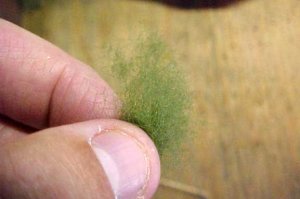

Next, I take a bag of WS Poly-Fiber, & pull a small tuft between my index finger & thumb...

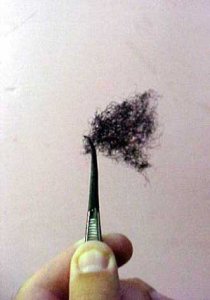

Next, I pull the tuft out into a random shape, roughly the size of a golf ball..then I spray it with some cheap flat black spray paint...

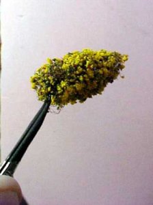

While the paint is still good & wet, I roll the tuft in one of the bags of the foliage...

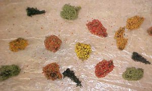

As I finish each tree, I toss them onto a piece of wax paper to dry...

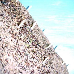

To 'plant' these on steep hillsides, I stick sectios of toothpicks, about 1/4" long into the hill, to act as "cleats" to hold the trees in place...

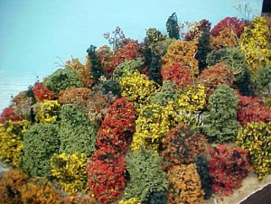

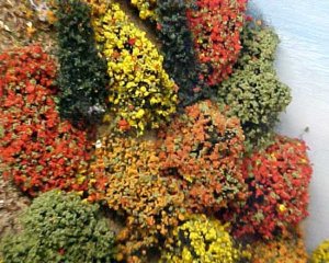

Then, using full-strength white glue, & working from the bottom up, I attach the trees to the hill...
This looked OK, but I really thought it needed something more... the "forest" just wasn't "branchy" enough...

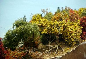

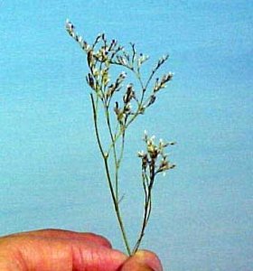

The solution came in the form of this stuff I found at Wal-Mart in the dried flower section...I think it's called "candy tuft", or something like that...(?)
Drew1125
Jan 28, 2001
2,975
I cut tiny sprigs of this stuff, & put as dab of glue on them, & just stick them here & there in among the PF trees...
