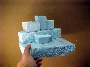

I was cleaning up the basement work room, & I found these scraps of extruded styrofoam. Instead of throwing it away, I thought I'd demonstrate how this material can be transformed into very realistic scenery, that weighs almost nothing. While this is a very small chunk of foam I'm working with, the same techniques can be used on any sized layout, in any scale.
[Here's the pieces of foam, glued together with an adhesive called Liquid Nails.

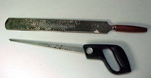

Here are the tools I used to shape the foam...A large wood rasp, & a keyhole saw.

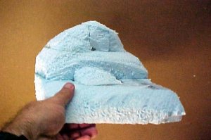

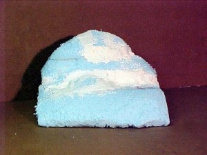

After I get a shape I'm happy with, I use some plaster of paris to fill gaps, & apply very heavy layers of it where I want to form some rock outcrops.

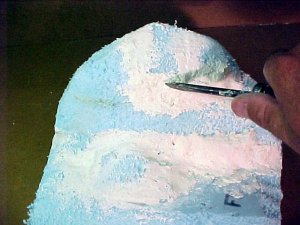

After the plaster has set up, I use an old flat head screwdriver to carve the rock face...taking very rough horizontal strokes, to form striations, & just generaly rough up the surface.

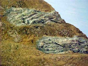

Using a spray bottle, I apply a black wash of rubbing alcohol & several drops of India ink as the base color for the rocks.

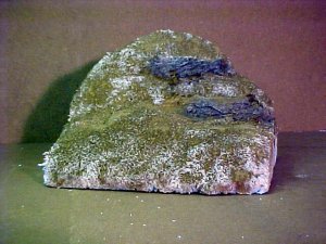

I finish the rocks by dry brushing them with some acrylic browns & whites.

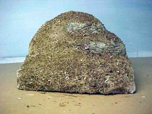

For woodland ground cover, I like to use material from what I call my "debris bowl".This is material left over from other scenicking projects...ground foam, dried leaves, dirt, twigs, even some pieces of styrene painted to look like rusted metal.
Here's what we have so far...now we're ready for trees!
