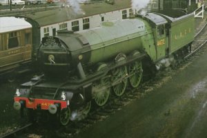

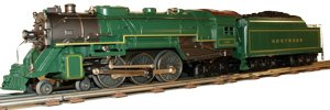

I thought it would be cool to take a Williams Southern Crecent and convert it to a Flying Scotsman replica. The only problem that I'm having is that it looks like there are two different versions of the real Scotsman. One has these big wing/flap looking things on the front and the other doesn't. Are there two different trains? Which is the prefered version to replicate?

OK, after some image research, I would say go with the wings. I think, THINK, those are actually on some Steams to grab air, possibly for cooling. And I am SURE that now that I made that statement, someone will tell us what they are really for:) From all the pics, I am guessing they are removable, depending on if they were needed at the time. But, I found more pics WITH those on there, plus, they look cool! Don't forget to rip the headlight off that Crescent, the Scotsman didn't have a light, they didn't require them in the UK at the time it ran...

The "elephant ears" were used on some steam locomotives for smoke deflectors. The idea was to get the exhaust steam and smoke above cab level. Some smoke deflectors worked well, others did not.
Early steam engines did not have the same problem because they had much higher draft pressures coming out of the stack. But higher efficiency requires a much softer draft, and with the soft draft, the smoke and steam would lay down along the top of the boiler, especially at speed.
Smoke deflectors were much more prevalent in Europe, and to some degree in Canada, than in the U.S., although they were used by some railroads extensively on high end passenger service. Development of steam engines continued much longer in those areas, and smoke deflectors were part of the development process. In the U.S., new technology developments for steam were pretty much halted by the end of the 1930s. If World War II hadn't forced the continued operation of steam in the U.S., dieselization would likely have completed in the 1940s instead of the 1950s.
The difficult part of the kitbash, to me, will be making the drivers look large enough. Lowering the walkways below the top of the drivers, as shown in the photos, will go a long ways towards achieving the look of the Flying Scotsman.

Going by the pics from the NRM, it looks like the "fins" were added on in later years. Personally, I think it looked better without them but they do have a practical function.

The "German style smoke deflectors" were added by British Railways, post 1948 sometime. They were needed after the loco had a larger blastpipe (chimny) added, and the smoke temded to hang around the boiler.
Flying Scotsman was sold toa private individual with a contract that allowed it to run on the main lines; it was the only steam locomotive allowed for years.
At various times in preservation, different features of Flying Scotsman's past have appeared and disappeared. Several paint schemes, smoke deflectors, a second tenser and, I think, a different boiler. Various howls from purists about these.

There is no difference between the two pictures you have. The one with the "elephant ears" will probably have a double chimney because the National Railway Museum decorated it for some reason. Poor Flying Scotsman. It has changed hands and apperance god knows how many times through its life. It was originaly a class A1 pacific but it then got modified as an experiment to a class A3 pacific. Then they added the corridor tender. After it was sold from LNER its paint went from that beautiful Doncaster Green to BR dark green. After the BR it was almost scrapped because diesels were taking over then a man named Allan Peglar bought it, restored it back to LNER, added the second water tender because all the water stops were disappearing. After they went on a world tour well US and Australia he sold it to BR again. They repainted the second tender to blue and grey and then donated it to the NRM. Thats how it got to where it was last year. But right now it is undergoing a 5 year rebuild to restore it to original. As for the second water tender, it did not get a happy ending. It was sold to a man who was restoring a Royal Scot. It got cut down and is currently a Royal Scot tender.
Aside from being green, there's not much similarity between the two locomotives. In fact, if you were to see the real ones side by side, you'd find the Flying Scotsman would be substantially smaller, thanks to the restrictive British loading gauge.
Well, it's the closest I've seen that wasn't a ready made Scotsman replica and most of those cost an arm and half a leg at least. IF you can find one in decent shape at all. I doubt it's going to happen anyway. As I said, I really don't want to go hacking up a $400 train with my limited modeling experience anyway.
