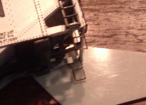

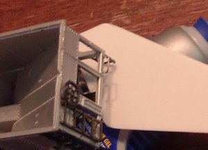

As wit most of my gear, came across this pile awhile back, looking pretty lost. While nice looking, I don't care for the latest in RTR cars that cost $25-40 bucks. This is a Tyco quad hopper that had one of it's corner steps broke off. Started by snipping off the remaining details....

shaygetz

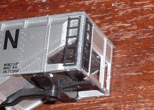

...cut off the truck mounted couplers and body mount a set of Kadees...

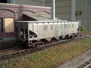

shaygetz

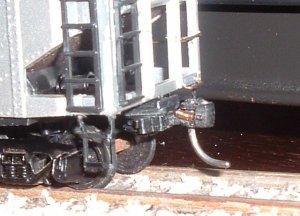

...touch up the paint and prep for weathering. I did it all while watching Jesse James and Kid Rock bebopping around Mexico on Discovery Channel. I'll post a pic when it's weathered (the transfer caboose gets done next weekend ;) )

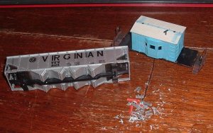

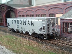

Thank you, guys. This is my cheif joy in the hobby, reclaiming toys and making them models. I'll never forget seeing a picture off of John Allen's Gorre and Dephetid. In it was a well done oil facility that, on closer examination, revealed the trucks to be redetailed and repainted Tootsie Toys. Kinda felt like I was part of the Brotherhood after that. Here's the hopper, with PK2 wheelsets (a very free wheeling drop-in fit in Tyco Talgo trucks), weathered and ready to go...

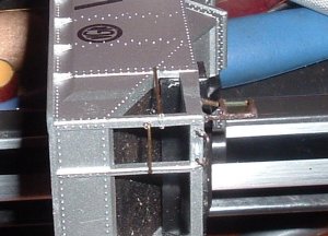

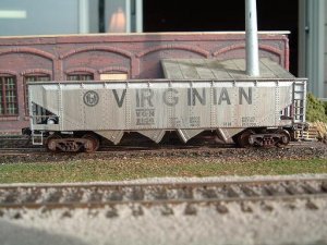

One more from the side. With all the fuss over the price of equipment nowadaze, I was hoping to kickstart a few folks out of the hobby of Acquiring Scale Railroady Stuff and into the craft of Model Building Type Railroading like it was when I was a youngun...goin' to the hobbyshop in the snow...barefoot...uphill....both ways...to buy brass track and poor running lokeys in three different (incorrect at that) paint schemes...gawking at $39 brass engines...sigh

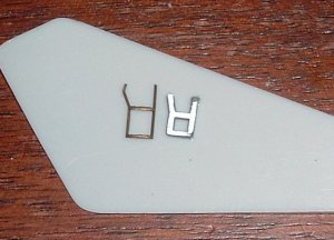

I little taste of my handy work on old tycos for ya.
