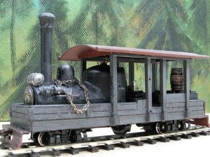

Well I have taken the plunge and scratchbuilt my first 0n30 climax body. still needs weathering and some more details adding but all in all she is finished. I only have one 0 gauge person at the moment. It was all I had to go with as far as scale. Not abit like making something in H0, still thinking H0 when I was making it and had to re-adjust my brain to 0.

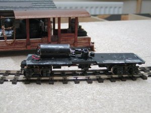

Ah Paul, a fine piece of workmanship. As usual, you give us something to strive for. I think you will enjoy the On30 size. Question, is that a powered unit? I would be interested in seeing an underside view.

Yes Paul,fess up.Is that little beauty powered inquiring 0n30 modelers want to know.:D

Okay guys, yes it is powered by an old shay chassis, but the chassis still works. I took this chassis to bits some time ago and cut off the coupler pockets so it would fit into a brill bus I was making, but never ever got around to finishing it so the chassis has been sat in a draw just waiting for this climax body to be made.

I like it very much. :D It's very interesting to see the changes from the intitial picture to the last one.
Does the frame is in wood?
What do you use for wheathering?
What kind of tracks are you using for HOn3? Peco?

Hi Jean,
Yes the frame was made out of wood strips and glued together.
For weathering I used chalks, grey & black for this model and rust for the roof.
The track is Peco 0 gauge- 16.5 (H0 track width) which is called narrow gauge
Cheers
Shamus
