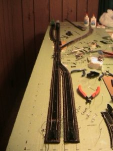

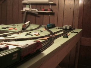

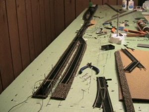

These are earlier.
Just had to show how much
of a mess I can make when I
really try! :rolleyes:

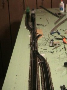

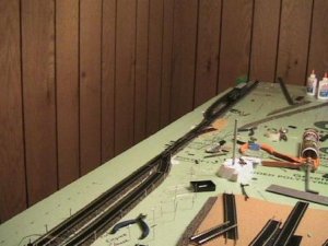

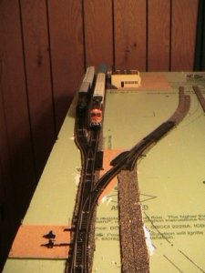

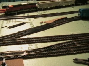

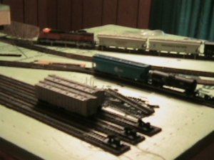

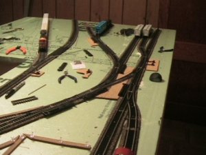

Most recent pix.
You think it looks bad now just wait, it'll really look bad when its done ! :D :D :D

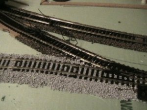

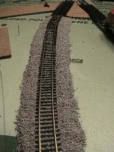

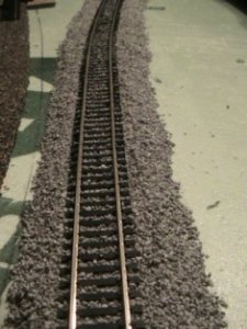

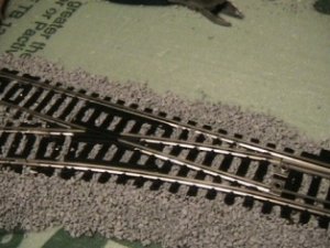

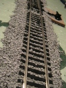

I spent the last several days just walking different rails and
have come up with this amount of ballast from the through
line on this section of the layout.
Question; does this look like to much for a newly balasted road bed?
interurban
Aug 21, 2002
4,407
76
Pickering. Ontario. Canada.
YEP:D
it always will when you first put it down. just like the real thing does.:)
But,, if you Paint your rails inner and outer with rust paint and let stain get on the ballast near the rail both sides, after adding some grass grow here and there, it will look like its been there a while .

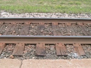

One of the areas I am using as a model.
CP line (Tomah/La Crosse)
Very old mainline but has been updated and well maintained.

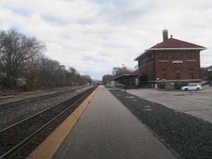

One more then I gotta do something today! :rolleyes:
There are various forms of transportation in our
little corner of the world, here are two ways for speedy
delivery other then trains. :D
