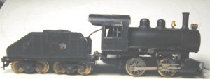

I know little to nothin about trains..the modeling and sentimentality aspects keeps me playing with Dads old set.. can anyone tell me what kind of engine this is?
Thanks.

Hi:
I can only tell you the basics. It's an 0-4-0, probably a switcher or a "yard dog" The tender shape reinforces this idea. The sloped back helped the crew see to the rear of the engine to make yard operations easier. I'd guess from the stack that it's from the early part of the 1900s. You might want to go out on the web and check out some of the steam engine sites. You'll probably find a prototype that is close.

Here's and old timers best guess:D I believe its a Varney 0-4-0 judging the construction of the drive rods, brass wheels and the open frame motor. Look on the underside of the tender to see if there is a name stamped in it. My other thought would be an Aristo-Craft by Polk Hobbies.

Vic's memory is probably better than mine, that it's Varney...I thought it looked more like a Mantua profile at first glance. Sure doesn't look like a European built engine from Rivarossi or Aristo. Most Aristo steam locos in the 50's had European-looking profiles. Main point is what is it made of ??? Is it white metal??...if so it can't be Rivarossi anyway.I think I've got a Central Valley valve gear kit that would fit this engine.

Mike R wins the guessing contest!!! Actually I have to apologize for my sometimes airheadedness, Mantua was right on the bottom of the tender, I just didn't look<blush>. Course knowing nothing about trains I still wondered from what era this train was from.
What I DO know is EXACTLY what it is made from. It's 95% zinc and 5% tungsten. I know this cause I tested with the 'metal taster', a rather nifty x-ray gun I use at work to determine the chemical content of metal alloys. Was fun to use it on something else besides stainless steel for once..... but really I did work hard today...lol

Actually, Tomboygirl, I wasn't guessing...I was just trying to get a "rise" out of Vic, because old Gord Varney, God bless his Soul, never made an 0-4-0 with tender...and I figured Vic should know that.
I believe that Mantua engine was known as "The Shifter" , and the kit sold for US$15.95 in the mid-50's. That was quite a bit of money for that time, compared to average earnings.

Well, the little 'Shifter' is running again, it seems to be very temperamental.
This time to get it running, after cleaning one connector at a time to no avail, I finally ran a bit of 400 grit wet/dry over the brushes a few times and it took off like hell!!!
Is this a fluke, or a valid fix? Only time, or someone here, will tell. :)

Hey Mike, Yep I got fooled on that one:D The way the drawbar attaches the tender got me!:D
Did y'all know that a lot of the Life-Like HO 40 ft. steam era cars are made from Varney's molds?
Tomboygirl...that's a fix but too much of that 400 grit paper will wear them out. Next time try some alcohol and a Q-Tip. Go to the LHS and get you a package of K&S fine emory paper...its 1000 to 1600 grit...great for polishing up the motor's commutator:) or in a pinch a pencil eraser will work.:)
