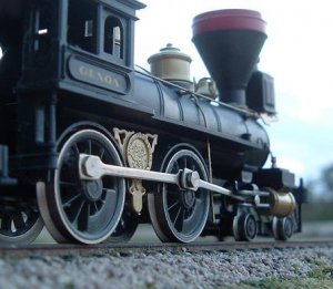

Bachmann EZ track would be C100, Xavier, and very easy for early AHM to run on. The biggest giveaway for AHM/Rivarossi is those "pizza cutter" flanges, the subject of many Model Railroader magazine "how to" articles on reducing them in size. Some folks would actually hook power to the engine and, while the drivers were spinning, apply a file to the flange to turn them down :eek: This led to many :eek:ops: smoked motors :eek:ops: and :curse: vile vocabularies :curse:. Take good care of it as they retain their resale value well.
Here's a pic of those flanges on a 1970s model AHM 4-4-0 Genoa....
