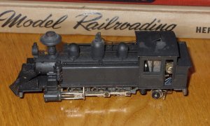

SML Puffing  Billy.jpg Some work done.

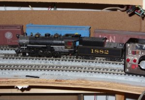

SML turntable w electrical  problems.jpg SML Southern  staging.jpg SML 4levels.jpg almost cute.
It is cute compared to the 0-4-4 outside frame forney that it will probably work with if I can get all of thier issues sorted out. they are both happy on the narrow gauge track but have occasional problems with the dual gauge .

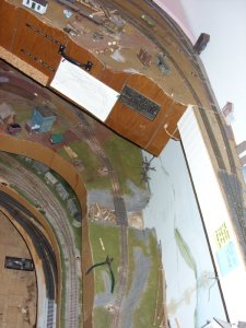

there is also a photo of the Southern interchange engine down in the southern staging yard; and a from the ceiling view showing Ridgemont, Montgomery frunace, the log camp @ Murray , and the Southern staging below that. Gegoukayoosa, on the narrow gauge is one level up.

Due to the curve of the layout @ the southeastern (actual, not as represented in the model world) corner of the layout, you can see all four levels there. Unfortunately the only curve under Gegokayoosa Is away from the aisle, so I haven't been able to get a photo that shows five levels.

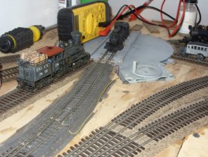

@the SL turntable.jpg @ the State line turntable
It was ugly but I was able to cut the center out of a couple of the ties on the added dual gauge turntable deck to get at the center screw. these screws have a tiny allen head that strips out. Either this was the one I've been in before, or that experience taught me to use a dremil to cut a straight screwdriver slot in the screw before I added the deck. Pulling on the deck I was able to screw it off the base, and so I did not have to disturb the track (thanks be to God!)
there are little spring loaded plungers that make contact with the contact plate on the base, and those plungers aren't soldered to the rail they just touch them. I cleaned up the contact points and reassembled the turntable with some dielectric grease behind and in the plungers, to help conductivity, and to hold the plungers in their hole against gravity during assembly.
back in the background of the photo is the Iron Mountain Ambulance, so anyone injured up on the mountain can be quickly and comfortably (right) evacuated to Dr. Gravestone's office down in the Berghausen-Shoemaker Lumber Co.'s Company store/office building down in Crooked Creek.
mission accomplished the dual gauge turntable is working again!
I did some investigating on the Puffing Billy's odd short crossing dual gauge switches. Operating the locomotive with a pair of 3X optivisor, made it obvious, the lead truck screw was just a tad low, and touched the rails in a dual gauge switch causing a short. with the optivisor on the spark was an obvious give away.
That locomotive's only remaining problem is occasionaly dropping its trailing truck on the ties when going backwards. I've got to get a standards gauge to it to insure it's gauged correctly, and if it is it will have to get a music wire spring ti try to help it keep centered.

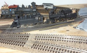

Here is a picture of it with it's uglier sister the 0-4-4 Forney. in the background is #18 a PFM shay. It's there for repairs. It has a NWSL gear reduction in it, and I stripped out the set screw on the motor shaft. Years ago I glued the gear on and that worked for 6 or 7 years, but it is slipping again, so I'm trying to decide if I should rig it again, or buy another gear from NWSL and fix it right. need to do something, as it is a real hoss, and is missed when it is not available for duty on the Mountain.

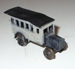

Dr. Gravestone is not fictitious . Grabinstien is German for Gravestone. And thus I translated and appropriated that name for the company doctor, as a tribute of sorts (we won't say what sort). I was also in the habit of referring to the area that the C&S inhabited as Gravestone County Tn . That seemed to escape notice, except from Dr. Tom, who I'm sure made the reference, but did not comment on it.

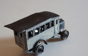

The Ambulance is a on-track white metal kit built around an NWSL flea drive. It runs well, but at higer speeds it will throw itself violently off the tracks.

You might try placing some weight on the floor or the underside of that ambulance to keep it on the tracks. After all, it won't do to have patients scattered all over the TN countryside....:mrgreen:

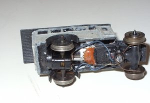

ambulance#1.jpg SML ambulance#2.jpg SML ambulance  underside.jpg Gus,
There is no floor! this is an on track kit, cast out of white metal, so there is some weight. The flea drive takes up the whole bottom of the ambulance.
I assembled the thing by gluing the castings , minus the floor, directly to to the flea drive. I glued a piece of brass tubing that an axle would just fit into under the nose, and then ran an axle through it and installed the wheels. it has some phosphor bronze wipers that center the wheels. it does OK, you just have to keep the speed down especially in reverse.
