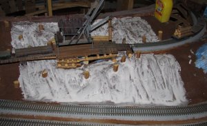

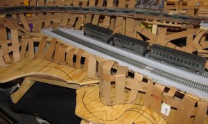

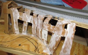

    I built in some scraps of plywood to make a small stream at the bottom of a steep ravine, to make the scenery in front of the log reload more interesting
    Then I painted the cardboard with white glue, and pressed some handi wipes into the white glue

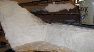

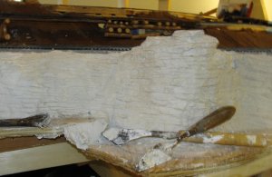

    After the handi wipes were in place I painted them with watered down white glue to stiffen them up some. before putting down the first bit of plaster I wanted to get a little bit of land form in closer to the aisle, but was in a hurry. I tried hot gluing the handi wipes to the cardboard, and that went pretty quickly. I did not have to wait for glue to dry , but sprayed
    hem with a water bottle to get them damp and slathered plaster where I'm going to carve rocks. elsewhere i painted the handi wipes with brown acrylic paint.

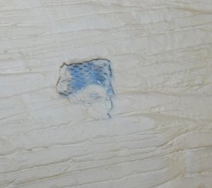

    I got a little more rock carved on the inside face of the ravine that will run in front of the log loading scene to make things more interesting. I had one spot on the rock I carved earlier, where I had carved a tad too deep, and hit the handi-wipes. I made the hole a little larger, pushed the handi-wipes in at that location to make a little pocket. sprayed the pocket and the surrounding area with water from a squirt bottle, and then filled the pocket with hydrocal, carving it as it set. then I carved the rocks in the rest of the inside wall of the ravine. I'm wanting to paint this right now, but, I'll get much better results if I let it set up really hard, and then five it a final scrub with a wire brush.

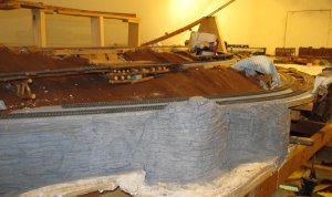

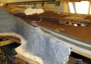

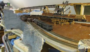

    I got back up to the RR room later after my yard work got rained out, and painted my new rocks
    at the base of these cliffs will be a small meandering streams. in places in the front there will be the other side of the ravine, hopefully making a some interesting scenes.

    Your rock carving is always amazing. The rock facings are big with incredible detail work at the same time. The 3D effect you are getting on this new scene is very nice. I really like the long lines of the rock work, the log loading site ,the long bridge, and foreground tracks. Nothing seems "cramped" at all.:Congrats:

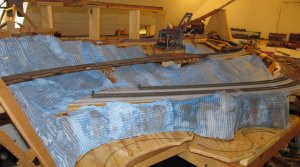

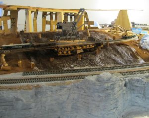

    I did some cleaning up of plaster debris around the log reload. installed more handi-wipes ( with hot glue this time, because I was in a hurry), and then painted it brown, and touched up where the plaster had got on the earlier brown. then I used hot glue to add some more cribbing under the loader deck, and added some stumps. I experimented with some building locations. I have not found the box with most of the logging camp structures. it may still be in the attic.
    this is a lot of fun. progress will get slower. I have to go to school tomorrow and help het ready for the next school year.

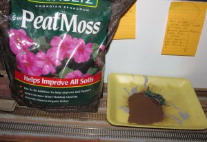

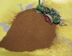

    This is a big scene, and as you know ground foam is not cheap. It was time to get out the blender. sadly It took me way too long to find it. I know where everything was two years ago when I tore up my old central peninsula. For years Dr. Tom and I have been running natural materials through the blender NOTE . . . . . . . . ( use a dedicated blender, either buy a cheap blender for use in the hobby room, or buy the cooking spouse a nicer blender, and appropriate the old one. Once you have used the blender for the preparation of scenery materials, it is no longer suitable for food preparation use)!
    any number of items can go into the blender, but one of my favorites for producing a forest floor material is peat moss from the gardening center. I put it in the blender and run it for a longer time if I'm wanting a more dirt like material, and for a lesser period of time if I'm looking for a debris strewn forrest floor. After I run the blender with the lid tightly on it. I let is set for 15-20 minutes to let the dust settle, and there is a ton of dust.
    In the photo above I have the bag of peatmoss from the garden center, and a tray with the stuff ground up on a meat tray, with Crazy Ed driving his team tractor though it for scale, reference. When glued down with white glue it is darkened somewhat, making a great multi textured dirt material.

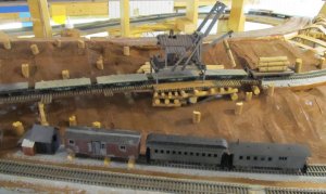

    First full day of school, after collapsing for a while , I got up to the RR room. I did some work around the log loading area, painting the hadi-wipe ground with white glue, spreading ground peat moss on it, and the spraying it down with wet water, it will need more work later, but I'm starting to get some ground down in this area. the glue, and the peatmoss will make this ground a lot stronger..

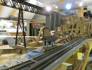

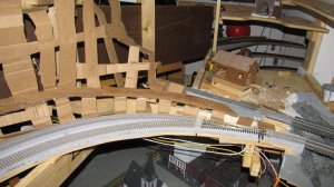

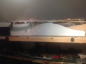

    Then I got over to the end of the back aisle, and worked on some lad forms. this area has some challenges, as the whole peninsula is only 28 inches wide at this spot, and there is a passing siding on the main on the front aisle, and the back aisle, with two narrow gauge tracks between them, way high. to get an idea of how skinny this scene is , I am including a photo of the same area on the lower level
    to the right at the end of the aisle I have my water powered sawmill which I scratchbuilt in the late 1090s, when I was still in college. it is going to set in a deep valley, formed by the narrow gauge main. I want to have the sawmill scene connected to the rest of the scene, so I have put a road on the cliff, running down from the narrow gauge roadbed. To make things interesting the road is elevated above the railroad tracks, and Likely I'll put some log cribbing in to support the road. In the main area of the central peninsula, there will be a small town, with some of my nice structures to fill in , especially St. Joseph's from the old Gizzard. A44a 8-10-16 red  river  bridge  a1.jpg
    the road starting off from the area of the station @ Perry's Gizzard, and then continuing into the area of the sawmill.

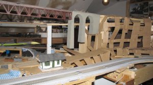

    It is the weekend weekend! I survived a week working at school; was totally exhausted, and had to take a nap when I first got home, but I recovered and was up in the RR room some while i was cooking dinner. Messing with cardboard land forms, creeping some scenic forms into the deep gorge of the south fork of Crooked Creek through Perry's Gizzard. I'm wanting to have some of the chimney rock formations in the new Gizzard, reminiscent of the ones in the old gizzard. I'm also going to want to place several buildings, to suggest a small mountain community along the streams. as the land forms go in, this is getting increasingly tricky. while the entire space of the gizzard is larger than the old gizard, the topology is even more twisted up, if such a thing is even possible. it is a lot of fun. I did some more work with the cardboard strips in the gizzard. this is slow going, as I'm working around some of the joint between sections of benchwork, and I'm trying to set up the scenery so that cardboard and the handi wipes don't cross between benchwork sections. hopefully If I ever disassemble this, the scenery will seperate more easily at the edges of the benchwork sections.
    I have the first of the two steel bents in the right place. still working on the shape for the land forms. I really like what is there, but may want to re do it, to facilitate building locations. I want to put a couple stores in there, St. Joseph's from the old Gizzard, and possibly the Wonderland Hotel from Dr. Tom's old layout.

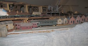

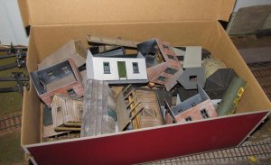

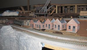

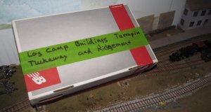

    as I had started to get some ground down at the log reload camp, I started looking for the box of log camp buildings. It took me a long time to find them; but i finally did. they were in a storage area under the lowest level of the central peninsula. this area is only about a foot tall, and I thought that only lumber scraps were down there. this box had stuff from the logging camp at Terrapin, TN., The log Reload fat Ridgemont, and the logging camp at Tuckaway, which split the difference between a logging camp, and logging staging. Some of these buildings are survivors form Dr. Tom's old C&S. I'm playing with possible locations at this time. Most likely most of the skid shacks will end up in Flea Creek, which will be more of a temporary camp, and the log transfer, which is called Sunburst, at least for now, will have some more permanant cabins, and buildings made from old car bodies.
    as I have been trying to do building placement in the Gizzard, I've run into lots of challenges. I think I did find a good location for Tom's partly done Wonderland Hotel building, off the tail track to the Wye. the weekend before last , I was working on some grant Line Reese St. houses, and was missing parts for one of the lean-to . that mystery is solved, I found it attached to another kitbashed structure. one or two of the Rese Street structures may end up in this scene. they are larger and fancier than the red cabins, and may be housing for the station agent, and the landing forman.

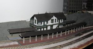

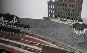

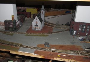

    Have done some cleaning up of construction debris down in Harlow. it still needs some careful vacuuming. although I have massive scenery work to do on the top level, that won't be as messy as the carpentry (God Willing), also Much of it can be put off for a time. I may start digging out some of the rest of the railroad so I can run some trains, or possibly work on various small projects spread around the whole system while I consider which of the remaining unstarted areas to start on next.
    Currently the huge narrow gauge Gizzard high Bridge, isn't hooked up to anything. One really fun project would be to build the 15 foot shelf to carry the narrow gauge across the eastern sloped ceiling to the Helix nook area, and then build the fourth level shelf to go on the south wall above state line . Then all that would remain is about a six foot shelf on the west sloped ceiling to tie all of the roadbed together for the narrow gauge system. the mainline track will be very simple between the ore transfer area in the Ridgemont TN. /State Line GA. area, and the shelf up above the State line shelf, where there will be a passing siding and an iron ore mine and a coal mine, with only a single switch leading down to the log reload area.
    another area that will have big operational benefits would be working on the Southern staging, under Harlow. The Southern Main in harlow makes a return loop, and I want to put a similar return loop in Southern staging. with three tracks on one side of the peninsula, and two or three on the other, That way, southern passenger and freight trains could come and go through Harlow. Some could be through trains, and some could drop off or pick up cuts of cars. When I get that operational, my railroad's operations will be more interesting than they have ever been.
    or I could extend the main line onto the central peninsula's lowest level. there will be three areas down there of great interest., Flea Creek, a very large logging camp, which will be a lot of fun to set up; Montgomery Furnace, where I will put in The Montgomery Iron Works, a much expanded version of the old montgomery furnace; and a town to support it. Last of all, there will be Terrapin, a return loop, with a passing siding as long as the return loop, which will be able to be used as a passing siding, and as Staging representing the semi Mythical Dead Grass, which hasn't been on the layout in the last 44 years!
    Nelson.

    Good to see some of those old C&S logging shacks being put to use. I used your white glue layer first scenery technique today to put in a gravel yard around the RJ Corman engine house at the club today. This was followed by sprinkiling on the gravel and soaking the beejeebers out of all of it with "wet water." The glue came up by capillary action just as advertised. Seeing the photo of the hillside smothered in Elmer's white reminded me of it all. I will post some pictures on the club thread later after the glue dries.
    Soaking everything wiped out the paper engine house sign and this will need to be replaced.:violin:Oh well live and learn.:hammerhead: Tom

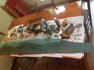

    I'm working on this back drop, behind the passing siding off the helix nook on the upper deck of the central peninsula.
    Here I have painted on top of the sky blue latex house paint on the Masonite with diluted acrylics, going for a look similar to the looseness I can get with water colors. Here is a detail shot. image.jpeg
    This was a lot of fun! I think it will look real good, This will be one of the first things you see when you walk into the room. I think this will help establish the mountain railroad feel.
