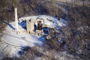

    Seeing Montgomery Furnace reminds me of my plan to model the lead smelter. Mind you this is a lime factory but the building layout would be similar. This is like a half mile away from my old house, it's the Western Lime and Cement factory that burned down... sometime (can't remember when). The ruins now sit in High Cliff State Park in Sherwood and at one point the factory had it's own town, complete with lumberyard, post office/general store, and a rumored depot. I have a book on the history of High Cliff but none of the pictures show this depot and only talk about it, since the original Wisconsin Central used to service the lime factory. As you can see from the overhead picture the furnaces that are left are similar to your iron smelters as they were rebuilt over the years, you can tell from the early picture that they looked almost identical to your smelters poking out of the roof.

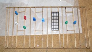

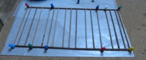

    more work SML A=1 14@ MF 2.jpg SML A=1 14@ MF.jpg SMLA=1 rftr rfrnc.jpg SMLA-1 rftrs #2.jpg
    I did some more work on the Crooked Creek engine house roof; getting the rafter locations marked on the rear half of the ridge beam, so I can add the rafters and get the spacing right for the skylight openings.and on the switches in Montgomery furnace.
    Over in Montgomery furnace I have been working to fix multiple broken solder joints on the code 55 switches. This time I'm using more solder, when building the switches I tried to use as little solder as possible trying to keep the switches looking good. Now I'm blobbing it on going for strength.

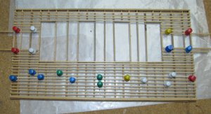

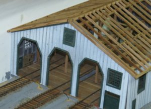

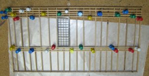

    SMLA-1  cc  eh rf #3.jpg SMLA-1CC E H bk  rf #1.jpg SMLA-1  CC  EH-1.jpg after a long period without any work on my Crooked Creek engine house, I have attempted to build the basic rafter structure for the back half of the roof.
    As it is, it is missing four rafters. these will be tricky, as I have to frame in openings for four skylights.
    I did not do that to start with, as I wanted to be sure the roof fits correctly, before I do so much fancy work I have test fit it, and it is just a hair tight, and that is good, as after I have the skylights framed and glue on the firing strips for the roofing, it will be a lot stronger, and I can lightly sand the front and rear edges until it is a perfect fit.
    Soon I will have to try to fabricate brass working hinges for the 6 double doors, a job that is going to be so much fun; (the reason I have had the doors ready for 6 months, and haven't hung them yet.

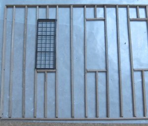

    SMLA-1 CC E H Bk RF  #3a.jpg since the back roof fits well, or will once it and the front roof are lightly sanded, I started to frame in the skylights. There will be an additional rafter added above and below each skylight opening. For skylights I am using City Classics factory windows, I also cut some of these down to make the windows in the walls. I also used them on my car shops and the sawmill.
    once I have those added then I can start adding firing strips. those will make each roof half stable enough to sand lightly till they are a perfect fit. then they will get painted with flat gray, and some flat black (from the smoke). after that I ca start looking for tin roofing material.

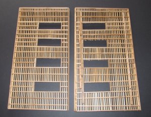

    SML A-1 fll rf frrng a1.jpg after all together too much work I have the firing on the rafters on the Crooked Creek engine house. After the glue dries haed, I can trim the skylight and edges flush, and do some sanding to get as good a fit on the building as possible .
    once that is done I will go ahead and paint the rafters gray, which will both color the wood, and seal it, which will help prevent any possibility of warping.
    I don't think I have enough metal roofing on hand, I will have to check. I already have some on back order, so I may have to check my records, and order a different brand . It won't hurt me to have way too much, my sawmill still doesn't have a roof, and Montgomery furnace and the iron ore transfer will need metal roofs as well, plus the tannery and God knows what else.

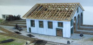

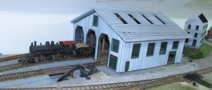

    SML A-1 CC EH DF pntd  @-a-6.jpg The roof has been fitted!
    I need to paint the edges, and the skylights green, but the fit is good, and I had some worries about that.
    Can it be done in N scale? That is a good question. My favorite Model train Magazine is the Narrow Gauge and Shortline Gazette, In building this model I'm desperately trying to match in HO, the quality of work I have seen photo of on On3 and Fn3 layouts. It is an article of faith with me that I'm unlikely to get all the way there, but If I keep trying I'm sure to get closer than I would have if I had taken the attitude of, that level of detail can't be done in this scale. It is all about working harder and harder to push the envelope and develop your skills. You learn stuff with each project; and the harder you push that envelope, the more you learn, and the better your stuff looks, so give it a shot, If you aren't satisified, and even if you are, try harder the next time .
    Most of us have a limited space to work with, and before we know it we are up against the four walls, and I my case ; I'm up against the ceiling too. at that point there is no where to go put toward more detail, at least in the important buildings that can be focal points. One great thing is our minds take shortcuts. If we take a building that is a natural focal point , and do insane level of detail, others looking at the scene will have their brain assuming that level of detail exists elsewhere, weather it does or not.

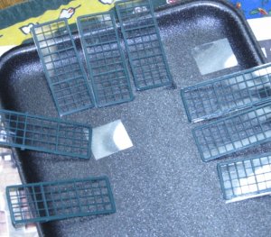

    SML A-1 Skylts.jpg Skylights!
    I just put the glazing in the skylights, after the glue has set up, it will be time to glue the skylights onto the roof, and check my suply of metal roofing, which I am rather certain will be inadequate.
