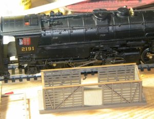

    SML12 11 10 workbench.jpg busy day.
    I got off of work late this morning , My relief was new, and I spent some extra time being sure she knew where the important stuff was, and what the schedule was.
    It was raining buckets. I was hoping to get some firewood work done, in advance of the coming winter weather, but no dice. stacking wood in the snow is much better than stacking it in the pouring rain. a shame to have it get wetter, but that's better than me getting wetter.
    I worked on the house instead, getting the red oak flooring almost done in the opening between my Master bedroom and my guest bedroom, which had been converted into a closet, but we have opened up. I also had to modify the door, so it would clear the new flooring. I also did some work on a sill between the bathroom I built the other year and the front hall. so I got a bunch of house restoration work done.
    While I had the tools out, I also cut some wood for the RR , and added some braces to the sub roadbed for the new narrow gauge return loop @ Georgia staging. I also cut some wood for where I want to cut out some of the roadbed @ the Gegokayoosa to add a curved stone viaduct, for no good reason .
    this is what my work bench looks like. The Broadway Limited y-6b is for the club, the largest Ho steam locomotive I have ever owned. In front of it is the 1st bark car, partly assembled. The Y-6b's were the last mainline steam made in the USA, and were very trchnically advanced, interesting machines. I weathered two AHM units for a member of the club I belonged to when I was a teenager, and I liked them, so when I saw a youtube video of the Broadway product I lost control and bought one. Now that I have fixed mine I will post a video myself.
    The bark car looks tiny because it is tiny

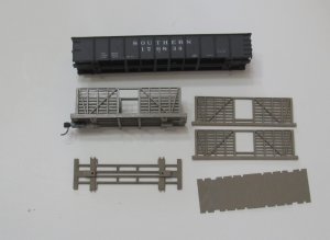

    SML HO cr prts.jpg Car shops
    Since the Southern staging yard is now workable, and the Tannery is under construction, I'm working toward filling in a car deficit, so operations will be more satisfying.
    I'm working on bark cars, and I have also gotten two Bowser Southern gondolas, which will, with the tab system, allow one a day to go to the iron furnace @ Montgomery furnace. ordered, but not here yet are two Tichy low side hoppers, and six Bowser dimension only box cars, six dimension only hopper cars (some may go to the club). I also have 6 Tichy train group 55 ton hoppers in the works, which will probably be split between my home RR and the club.
    Besides the two BTS open roof Civil War era cattle cars I am building as bark cars; I have another two I haven't started yet. I have one of their flat cars, and five boxcars I haven't started yet. These will all be DG CC & W RR cars.
    So I have lots of cars to work on, another switch to splice into the Southern staging yard, and some sub- roadbed to spice on to it to extend it so it can hold one passenger train and three freight trains. Then it will be time to make lots of tabs for the tab on car operating system. I probably need to order a bunch of Evergreen styrene I beams, which I cut up and paint to make the tabs for the tab on car operating system.
    They are doing some work on a roof near where I work, and I have snagged some scrap 2 inch dense Styrofoam, which I will cut up and carve to make some removable scenery that will fit between the new narrow gauge return loop @ Georgia staging, on the fourth level, and the iron mine @ Gegokayoosa on the fifth level, adding some scenery to an area I had envisioned as just shelves.
    In the order I got I also got a brick smoke stack for the tannery. I will be lettering it soon and will share my technique in later posts.

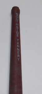

    SML ltrd smk st..jpg SML ltred smk stk.jpg SML mkstk #2.jpg I got a one piece brick smoke stack from Walther's for the tannery. I painted it with gray and white, and then stuck vynal letters on it. Once the letters were on it I spray painted it with white and gray again, so that any paint that creeped under the letters would match the white underneath.
    then I painted the whole stack dark gray . Next I will dry brush brick color on the surface of the bricks trying my best to keep it out of the mortar cracks. when I have done that I'll use an exacto knife to peel off the letters, hopefully leaving near white lettering.

    SML ltrs  unmskd.jpg SML pntd smk stk.jpg I drybrushed some brick red over the smoke stack, and them peeled off the vynal letters, and got the dirty white lettering I had hoped for.
    If you click on the horizontal photo to get the increased size photo, you may be able to detect the vynal letters.
    I have used this reverse stencil method to do a lot of signs on brick buildings. You can get really fancy and paint bricks first then partially cover it with with white paint, but the letters on over that and get the look of paint flaking off the painted sign, showing the bricks underneith.
    By naming the Tannery Southside Tannery; and putting the name prominently on the smoke stack, I help establish the back side of Harlow as Southside.

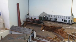

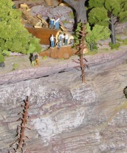

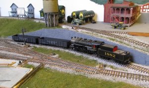

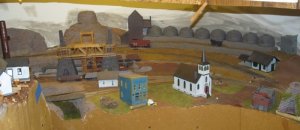

    SML   IRN mine.jpg SML  SOU GONS.jpg SML  trpn knb  grp photo.jpg SML mntgmry frnce.jpg SML TNry w smkstak.jpg playing with new camera
    I'm playing with a new camera, working on the learning curve toward getting good miniature photos, I photographed some random stuff in the mountains.
    The top photo is the big, as of yet un-named iron mine @ Gegokayoosa NC. on the narrow gauge.
    The second photo shows two accurail sou rwy gons I just built. these will go back and fourth from the Southern staging to Montgomery furance, hauling pig iron, as soon as I can make the tabs.
    The third photo is the woods crew @ Terrapin knob, posing on the stump of what was the largest tree in Gorre County Tn.
    Next is a photo of Montgomery furnace.
    last is a photo of the smoke stack @ the Southside Tannery in a trial position, I will need to build a powerhouse near by, and build a coal dump into that trestle underneath the hopper car.

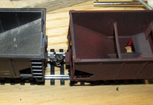

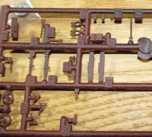

    SML tchy hopper  #1.jpg SML TCHT hpr prts.jpg Oh, and while we are at it some one tell the guy on the boxcar to get his *** down, he is seriously silhouetted, and that isn't good, unless he is a bad guy.
    I also have been working on freight cars. I have a bunch of cars on order from micro-Mark, which are not here yet, I have been poking on a six pack of Tichy Train group 55 Ton Hoppers. These cars are beautiful, but the six pack was an error, too much work.
    Click On the parts sprue photo to expand it, and check on the rust texture I get by mixing red auto body primer, and flat black spray paint, spryaing one before the other has dried.
    I'm leaving off the air brake piping, and some of the brake gear, but there are way to many pieces for these things for some one like me who is trying to fill up the staging yard to get ready for operations.
    In the first photo you can see what the scale thickness of a Tichy car looks like next to an average HO hopper, and the second shows one of the many sprues of litte details, some of which will be added, and others may go to the workbenches in the car shops If I ever super detail the inside of that cardboard building.
    Even the basics of the add on details will take quite some time, especially when you consider the individual grab irons. I had originally planned on most of these cars going to the club, but they may stay on my RR due to the fragile nature of the scale profiles. These will be J. E. Patterson Coal and Lumber Co. cars, so if they stay on my home RR, it will look like we are doing a lot of business.
