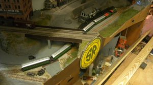

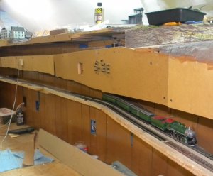

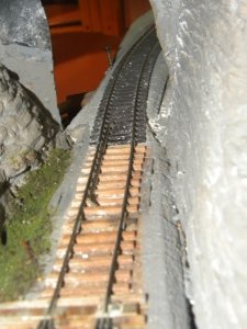

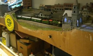

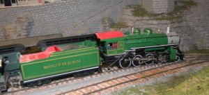

    SML a   SOU  Pass  loc.jpg SML a  sou  pass trn  in Sou  stgng.jpg SML a Sou pass  trn n Hrlow.jpg SML a nw grd rl..jpg work session
    It has been a long time since I have done much on my railroad itself, other than some track cleaning and maintenance.
    I got up there this morning and did some track cleaning , and then addressed a problem.
    I had been wanting to run Southern Railway passenger trains into Harlow Tn., but my Bachman Southern RR Green and gold 2-8-0 could actually negotiate two out of three of the branches of the code 55 three way stub turnout at The Harlow Terminal, it dropped it's lead truck up in the cut, under the highway underpass, where the track transitioned from code 55 hand laid track to code 70 flex.
    Careful study showed the track was all in gauge, and the problem was due to a vertical curve ( a change in the grade). By adding a code 70 guard rail at the offending spot, I was able to get the hefty 2-8-0, which runs very smoothly , into and out of Harlow Tn without a problem.
    My original plan was to have the Southern Passenger train move forward into the Terminal, and back out. However The KD permanent under the tie uncopler magnet caused problems. It is absolutely necessary for the smooth operation of my freight interchange; so for now the Southern Railway passenger train will back in and head out going forward.
    The Bachman 2-8-0 is a excellent running locomotive, and is very well detailed. In it's very well done Southern Green and Gold passenger scheme, it is not acurate for the steam era. This was a freight locomotive. One of these survived to be a part of the Southern railway's steam program in the 1970's, and was painted Green and Gold for steam excursion service. This paint job is correct for this locomotive, but just barely. I retain it, because I don't feel like building a proper Southern railway passenger locomotive, and could not do this good a job with the iconic green and gold paint job.
    you can now ride into Harlow TN. on a Southern passenger train, to begin your travels in Gorre County TN. on the DG CC & W RR
    The photos show the SR train down on the southern staging tracks two levels below Crooked Creek, the Bachman 2-8-0, the train in front of the Harlow Terminal, and the gaurd rail that makes it all possible
    Bill Nelson

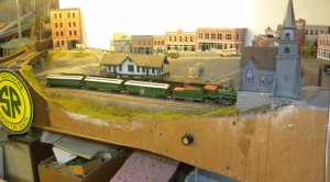

    SML lng Sou pass trn #1.jpg SML SOU  long pass trn #2.jpg longer Southern passenger train
    I snagged another Southern Combine and passenger car from Dr Tom's old Southern interchange train, and added it to mine, so I have a longer Southrn passenger train. I can back this train up the helix and into Harlow without incident, after tweaking a couple of the trucks on the passenger cars. Getting these cars from tom was a wonderful thing, as they are not for sale in the Southern scheme at this time.
    I may cut off the magnetic whiskers, so I can run the train in forward and back it out. if I try that right now, I get an unintended uncoupling, that sends the passenger train hurling down the helix. before I cut the whiskers though perhaps I should replace the stock Bachman couplers on the 2-8-0 with KD's. The bachman couplers don't do the delay uncoupling trick, and perhaps the KDs would not uncouple unexpliclably under tension crossing the magnet. the magnet in that location is critical for the Southern dropping off freight cars.
    Bill Nelson

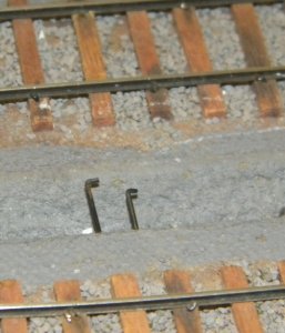

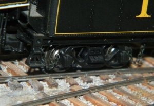

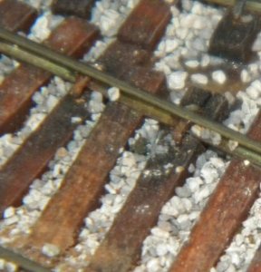

    SML some plcs I didn't  want to pull  spikes.jpg SML SOU tndr in a bind.jpg sml spks tht  intrfre  wth  flgway.jpg Spikes #1 Harlow project.jpg More Harlow rehab work
    I have been doing some more rehab work in Harlow. in some places I am using an NMRA standards gauge to find where sloppy spiking interfered with the flangeways on the code 55 track. Back in the Dark ages Lambert made very fine spikes that would work well with code 55, but they have not been available for the last 30 years, and we have to use whatever we have.
    whatever I had, when I started Harlow was too fat, and often left me with not enough flangewy. I have smaller skies now, although the smallest will fold up before they will go into my yellow poplar ties.
    My massive Sou 0-8-0 switcher, a proto 2000 unit, now can negotiate the inside track od the 3 way stub switch that is closest to the Southern staging, in spite of the kink. it is tight though, the front tender tuck actually lifts off the rail, but it hasn't derailed yet.
    The top picture shows one of my 3 way stub switches . locations I did not want to pull spikes from. So when they were in the flangeway, I filed them down.
    the second photo shows the lead tender truck @ the place where the bind lifts it off the rails.
    In the third picture you can see an offending spike, and in the fourth you can see a size comparison between the ones I'm removing and the smaller spikes ( Micromark small spikes) that I am replacing them with.
    the operation in Harlow is getting smoother as I resolve the flangeway issues. Harlow may yet be salvageable.

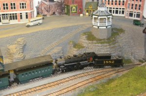

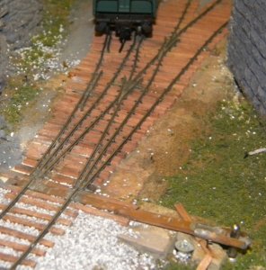

    SML  #wy sw  wth  filed  spiks .jpg SOU 0-8-0 on insde Hlw trc.jpg more photos of the track progress in Harlow
    In the overhead shot of the 3 way stub switches the shiny spike heads show where the spike heads were filed down for more flangeway clearance.
    In the second photo the Southern 0-8-0 is in the spot where the front tender truck is lifted off the rails on the inside. As long as I go slow, it has landed on the rail each time hasn't derailed yet. Slow is the standard procedure anywhere near 3-way stub switches anyway.
    The three tracks in front of the terminal are working better than they ever have. I am now over on the back side of Harlow (Southside) working on the flangeways over there. If I can get that area squared away I may need to get to work on the tannery and the associated rolling stock ( bark cars, and hide cars).
    Bill Nelson
