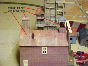

Dry Brushing Examples
Hi Woodie, Here's a pic of some dry brush weathering on tin roofs. I used various rust colored paints.
