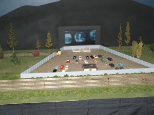

Here is a photo of a drive-in theatre at a train show in Chilliwack BC. I'm not sure what sort of receiver was used for the screen, but they did mention that it was fed off of a DVD player. Notice the child's play area just below the screen. I could almost smell the aroma of popcorn and hot dogs coming from the snack bar. The effect was all too real, bringing back some memories I thought I had blocked forever. Memories of those days when I actually liked girls more than trains!
