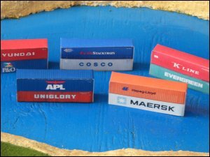

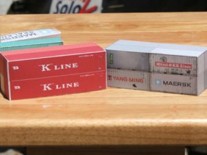

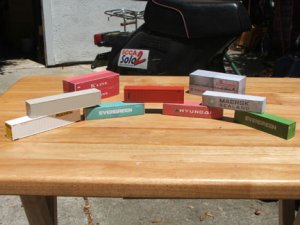

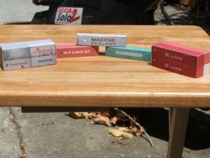

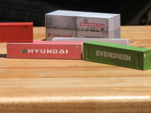

Here they are.
Well after finding out I could buy a new All-In-One printer for the price of replacement ink for my current printer, I got some of the containers made. It took a little playing around to get the images resized, but I figured it all out. I have only made a few so far, but they are really easy to do. I printed them on 110# card stock from Office Depot. The first one I did I tried cutting it out with scisors, and then fold it in to shape. That turned out to be a pain, took way too long and couldn't get the folds right. So I used a metal straight edge and an Xacto and cut them out on a metal surface. Went way faster, they for the folds I lightly scored the card stock with the Xacto, just cutting the surface. Then they folded great, and the lines look sharp and great. Here are the pics of the finished product. just looking at them from a foot or 2 away, you can't tell the difference. If you inspect closer yuo can tell they are not plastic, but they look great. By them selfs with out any plastic containers next to them, they look like the real thing. So I am thinking of not sing any of my plastic ones, and just using all paper. That way they don't contrast each other. Let me know what you think. And if anyone wants any specific container images resized to N, let me know.
In the first pic, you can tell which ones are real and fake, but you have to look.
