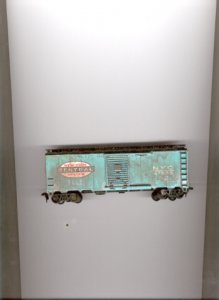

Since I don't have an airbrush, I use pastel colored chalks with good results. I use a combination of burnt and raw umbers, burnt and raw siennas, black and charcoal gray. I scrape with an exacto knife to obtain a fine powder, then brush it on my cars with a bairly damp make up brush I swiped from my wife. Once I'm satisfied with the coloring, I spray it with Testors Dullcoat to afix in place. Here's a pic of a heavily dirtied up car with that method.

Actually, I just stuck it in my scanner:cool:
Since I don't have a digital, it's quicker than even the " 1 hour photo" method w/ my 35 mm.
Matt--Hershey, Pa.

Matt, Would of never thoght of putting a car in the scanner, seems to work great. Maybe I'll try one of my engines since I don't have a camera either! P.S. You might want to run that car threw the washer, It's kinda dirty!!:eek:

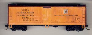

The main advantage is, if you foul up with paint you really got a problem, with chalk you simply remove it and start again. The pic here is my fiest attempt of weathering with chalk.
Matt, thanks for the demo of direct scanning of 3D objects, I just tried it and it's great! I also go along with your choice of the chalk colours.
