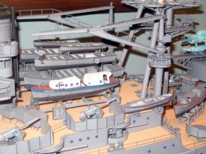

Boats finally finished!

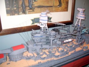

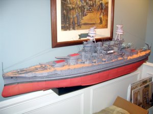

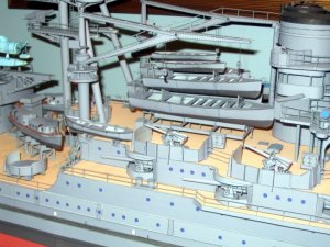

I've completed and mounted the last of the ship's boats. I feel like I just won the lottery! Now I can get onto the business of wrapping up some small details, ladders and rigging, etc. I'm in the home stretch now!
I've touched up the seams on the small boats with some special-mixed polyscale paint. I tried to match the hull color as best as I could. At least the black lines are gone and it blends better now...

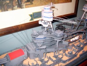

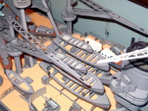

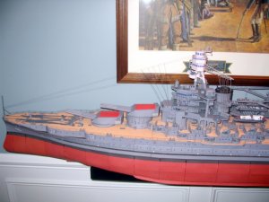

I've completed most of the kit-built parts for this model, so it's close to finished. Right now I'm adding the rigging (denim thread) and I'll be adding some after-market details to enhance the overall appearance. Items like 25-man life rafts, 12" signal lights, draped hoses and even a few sailors "at ease" to help give proper scale...
As far as the rigging is concerned... The denim thread I'm using seems a nice size for this scale and has a good twisted rope look. It's easy to work with and easy to imbibe with CA glue to get a stiff look. I've put all the rigging forward of the forward spotting room/mast and I've worked in all the signal flag lines on the port side of the ship. More to come!
