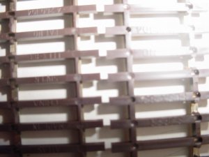

Over the past year I have been stocking up on Atlas Code 83 flex track. Most is from the two model train shops in Houston, I also bought some at a train show last year. Anyway, I was going through the inventory tonight and discovered that I have two different types! Both of them have "Atlas" "Made in China" "Superflex 83" and "Patent No. 4260104" on the bottom.
On one type, the ties are slightly bigger, and the plastic connections between the ties are alot bigger than on the other type. As far as I can tell, they are both nickel-silver track, and they were sold as nickel-silver track. The rails look exactly the same in size and color.
Is there any possibility that the bigger tie stuff is old brass track? Has anyone else seen this?
The pic isn't that great, but notice the ties on the right are a little bigger, plus the plastic connections between ties are bigger.

Brass rail stopped being made before code 83 rail was introduced - I've never seen or heard of any brass code 83 track.
The larger ties might have come a different Chinese manufacturer, or more likely IMHO the code 83 rail (if it is code 83 and not 100) was mistakenly added to the code 100 tie strip. The Atlas code 100 flex track has larger ties than the code 83, but the code 83 ties are actually thicker than the code 100.
just my thoughts

On the bottom of both types, it says "superflex code 83" which is molded into the ties. I compared the rails, and they are the same in all dimensions.
After looking at the track even closer, I see that the tie plates on the larger ties are bigger, plus the "knobs = spikes" that hold the track to the ties are bigger too.
Perhaps this is older Code 83 stuff... and originally Atlas used the code 100 tie dimensions? I suppose I should send an inquiry to Atlas.
I have just enough of the bigger tied track to do my "maiinline" and I will use the smaller tied track for the spurs and yards.

Your guess about an older lot is probably better than mine. Atlas will likely replace the older track if you ask. But that's your call, because the exchange may take a couple of weeks (and possibly delay your track laying).
The "knobs-spikes" being bigger concerns me. Before committing to a course of action, I would run your deepest-flanged equipment over pieces of both track types to ensure you will not have flange clearance problems on the older track.

I can tell you difinitively that what you purchased is Atlas Code 83 rail on Atlas Code 83 ties.
Atlas's code 100 had a tie profile larger than the two shown, combined. Also, the Code 100 is black while the code 83 is brown...and the code 100 rail wouldn't fit code 83 ties.
All you've seen is that the tooling was a little different on one die than the other. Things like that are common when dealing with Chinese companies...Precision Scale lost a bunch of masters a few years ago when the Chinese firm dissappeared overnight...I know because I got one of their last DSP&P domes before the incident, and a friend of mine wasn't so fortunate.
For future reference, brass rail is the same color as any unpainted brass locomotive or brass home fixture. (technically nickel silver has more in common with brass than nickel or silver :)

This topic was justed discussed on the Atlas forum - Paul (Atlas) stated that the flex track tooling had been updated, so that is the difference.
