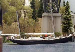

Just a thought,
23" radius, 13" span, a double width bridge (13" long) could carry the curve, with support only at the ends of the bridge. Shorter single width bridges, at angles, technically would require support at each bridge joint. This could be accomplished with simple steel bents, stone abutments, or cast concrete.
The concrete abutment behind the sailboat (HO scale) was built from broom handle, and balsa sheet.

Sumpter's Boat
Hi all, my appologies to Cookyy for breaking the cardinal rule of not deviating from the thread topic, but, Woh......Sumpter...what a yacht! Did you build that schooner yourself???? What a beauty, the skipper must be real proud when he participates in the commodores sail past. What is she....50-60 feet?
BTW, you wouldn't know where a guy might find any plans or HO models of an old circa 1920s lumber schooner....would you?
Stan

Sumpter,
I really like the bridge abutment! I'm always impressed by effective models that are constructed from readily available materials like a broom handle! Cool!

PETE
I 'M KIT BASHING ALL READY ( AND IT ONLY TOOK A WEEK TO GET UP THE GUTS TO DO IT )
Q. IS THE PIER IN THE PHOTO HOLDING UP AN ARCH ?
Q. DO YOU HAVE A PHOTO OF THE BRIDGE AND PIER ?
PS NICE BOAT TOO
