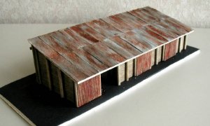

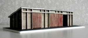

Well, after the Water Tower I thought I would tackle this kit... Don't ask why the scratchbuilding came before the kit :rolleyes:
This is the Coal Dealer kit from Brian at Hamilton Model Works. It went together really quickly, once I had gotten over my initial fear of doing it. I guess that's because I paid $$$ for this (well, maybe only $$: it was about $15 on sale).
All the wood was finished with alcohol/India ink wash. The doors were dry brushed with red craft paint. The roof (each panel is a scale 4'x12') was dry brushed rust using a small bit of foam, then washed with the ink, then DullCoated, then washed again.
The coal pile inside is actually blue foam underneath, with aquarium gravel stuck in black craft paint while still wet.
I hope to put a light in the interior.

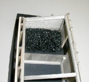

Interior space.
Only one bay is finished because only one has the door open, and the others are not really visible from "outside".

very nice work, Andrew.
I remember a real coal dealer here in town, about 20 years or so ago, and he had his shed build to match the curve of the track at the back of his 6 bay shed. It was to facilitate unloading, I guess. I took a bunch of pictures and measurements of the setup but have lost them in a couple of house moves.

Thats a sweet looking structure you have scratchbuilt, nice effect using the ink wash.

A truly fine model, Andrew!
I love the aged look of the wood. Your method of creating the rusty roof sounds quite elaborate, but doing so many passes really paid off - fantastic effect!
