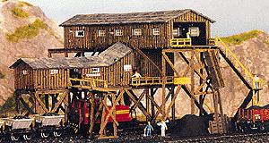

Hi Terry and welcome to the gauge, here's a photo of a coalmine.

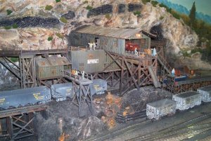

Coal mines are great modelling ideas because they can be so varied.
Here is a shot of a scratchbuilt version of the one Shamus posted, built by the Salmon Arm Model RR Club.

Curious
Just curious on how this mine functions as I have the similar kit...I see the lower tracks have shorter hoppers I am assuming for raw ore materials? and the upper rails with full-length hoppers are for the refined materials? Just a guess, but if someone could explain it to me I would be greatful.

Shamus, lighthoresman,
I haven't seen that pithead building since 1960. I built it with balsa sheet and strip, when the article came out in Oct.,Nov., and Dec. 1959. It was another one of Jack Work's projects, and was fun to build. The article appeared in Model railroader.
justind,
The building was a pit head building of a coal mine. Coal was separated out, and dropped to the lower building (upper track), where it was graded. The tailings continued out the upper building, and down the one chute into awaiting cars, to be hauled away and dumped. What you don't see was the hoist house, that brought the mine cars up to the top building to begin the process.
