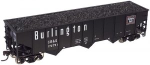

    With your help I think I found the right CN coal hopper:
    Bowser Mfg - Pennsylvania Class GLa 2-Bay Open Hopper w/Accumate Couplers; Ready to Run -- Canadian National (brown)
    Pennsy's Home-built Hoppers in N Scale from Bowser ? Pennsy's first all-steel hoppers were built in 1898 by Pressed Steel Car Co. but design flaws and production backlogs convinced Pennsy to construct their own improved version, the home-built GLa class. These hoppers became a PRR standard with over 30,000 built between 1904 and 1920. The cars lasted into the 1960s and a few remained in work train service into the 1980s. The GLa class was one of the most common coal hoppers in North America, so they'll look right at home on your steam- or early diesel-era layout. Ready-to-run GLa Hoppers from Bowser come equipped with AccuMate(R) knuckle couplers and feature authentic paint schemes. ?
    [​IMG]
    Any coment about that choice ? I think it'll look good coupled to a CN GP7
    Jacques

    Many of the Bowser schemes are correct for the GLa, but I don't believe all of them are. I personally think that they're more toward the beginning of the transition era than the end of it, but it would certainly work.
    The three bay 70 ton hopper-- DUH!-- I'd forgotten about the Athearn/former MDC version. I had only the Con-Cor in my head when replying, and they aren't that easy to find so I didn't want to bring it up.

    That looks good....although the couplers seem to stick out far too much. Are they truck-mounted couplers..? I'd replace them with body mounted KD5's...

    Gus, I see your point.
    In my case, I'm not modeling an Apalachian coal-hauling line. Both my small oval and my switching layout are centered on the brewing industry, so I just need a couple of coal hoppers to fuel the brewing kettles.
    I didn't find any Canadien National coal hopper at my local hobby store nor with my online Canadian dealer ( Pacific Western Rails System ), but the Norfolk Southern one is . I often see NS cars on the CN line down the road, so it would'n look out of place on my CN layouts.
    Jacques

    That is a pic of an N scale car. The HO version has better coupler spacing and looks great!

    No, I was answering another post about the coupler spacing, that referred to replacing the coupler with Kadee #5. That is an HO coupler.
    I think the hopper in the pic looks great for N scale, and believe Bowser cars to be great investments, though I am indeed in HO.

  18. brakie
    brakie Active Member
    Nov 8, 2001
    2,950
    Gus,The BEST solution would be to use MT trucks with short shank couplers..Of course advanced N Scale modelers are body mounting the couplers.
