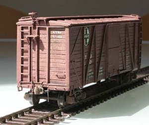

    Steamhead, that’s exactly what I feared before I started: to end up with just another boxcar, nothing special.

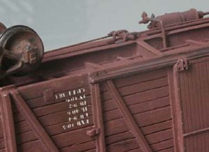

    OK, here is an update on my project. I painted the trucks and couplers and tried to apply dry transfer decals. As you can see in the pic, some data is still missing. I nearly used up all the decals that were on the sheet. It is very difficult to apply the dry transfer decals between the braces of the car without damaging the decals. Besides the logos, the results do not satisfy me. I think I try microscale decals.

    I got this advice on how to apply dry transfers from a guy at one of the local clubs:
    • Make sure that the finish where you want the transfer is clean, oil/grease-free (from fingers, etc), and is a matte/dull finish. (Waterslide decals need a smooth or glossy finish.)
    • Cut the transfer to the shape of the space where it is going, even if you have to cut apart some lettering (like the ATSF on your boxcar).
    • Tape it in place with scotch tape or other tape that won't damage your paint.
    • Tape along one edge only so you create a "hinge". This allows you to lift the transfer to see if all the lettering has be affixed - if not, you can put it back in exactly the same spot.
    • Rub with a soft pencil (2B, 4B, etc). This will let you see what has been transferred and what has not.
    • Be sure to rub the transferred letters with the backing paper. This ensures that the transfer is firmly in place, and "seals" it.
    • Seal with DullCoat or other matte finish.
    I have tried to follow this - and it works every time. When I don't get the results I want, it is usually because I have skipped a step, or rushed things.
    Oh yeah - the guy from the club? Tom Hood of C-D-S Lettering :D
    Andrew
  9. cnw1961
    cnw1961 Member
    Jan 8, 2006
    936
    Thank you for your nice comments, I am glad you can’t see me blush :oops: .
    Steamhead, I didn’t have the end result in mind when I started, it developed just the way you described it.

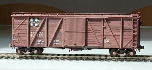

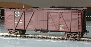

    Andrew, thank you once again for being so helpful. To fix the decals with adhesive tape is a very good idea, I’ll have to try that the next time I use dry tranfers. I think I followed all the other points on your list. The main obstacle might have been the high temperatures when I tried to apply the decals a few days ago. It made the decals very soft and my fingers sweaty. Today, when I made my last attempt (because I only had enough decals left for one last try) to apply the decals, it was much cooler. And it worked much better.
    And now IT IS DONE. Here are the last two photos. I really enjoyed to build this car and I already ordered two sets of doors (metal doors this time) for the next two cars. I found a photo of an ATSF wood boxcar I want to model and I’ll try to stick close to the prototype this time. If you are not totally fed up by now, I will post some pics.

    Gus, as I am living in Germany, I am a bit restrickted when it comes to american modeling stuff. I can order everything from Walther’s at my LHS, but that is nearly all I can get. Everything else I need for scratch building (styrene, stripwood, wire), I buy at a local architectural model supply. I think I am lucky to have this shop in our town. Here is a list of items I used to build this car:
    Accurail wood boxcar as a sample
    .040 styrene – body, roof, floor, braces, underframe
    .020 styrene – braces on top of the roof, first 2 braces on right side of doors, backside of doors and lower door tracks
    .012 styrene – base of braces and on corners, underframe (have a look at the pic attached to this post)
    .040 stripwood – sides, bottom of floor, roofwalk
    .012 steel wire – grab irons, brake
    .020 steel wire – vertical brake staff
    .040 brass wire – air hoses and air pipes
    Tichy Tarin Group #3005 – K-brake
    Tichy Tarin Group #3017 – wood doors and door tracks
    Tichy Tarin Group #3033 – freight car ladders
    Tichy Tarin Group #3038 – stirrups
    Kadee Bettendorf trucks and #58 couplers
    Woodland Scenic dry transfer decals # DT601 and # DT604
  20. viperman
