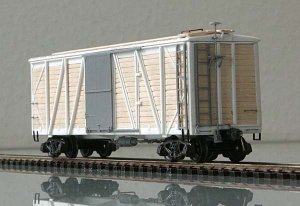

After installing a K-brake (Tichy #3005), the car is ready for painting now. I hope, I didn’t forget any important detail. I will paint the car box car red (what a surprise :D ). I still don’t know how to paint the underframe and the brake gear at the bottom of the car. In some pics of these boxcars, the color of the brake cylinder is grey (or faded black). Unfortunately it is not possible to determine the color of the underframe. Does anyone know how these parts were painted on the prototypes? Or was box car red used for the whole car?

The boxcars of this era at the Smiths Falls Railway Museum (www.sfrmeo.ca) are all boxcar red - underframes and everything. I think this is because the red oxide coloured paint was cheap and plentiful. The black/grime colour maybe comes from the unfinished colour of the metal used in the parts, and/or from the lubrication/dirt/dust/grime that collected over the years.
Go to the site and click on the collection link. There's three or four outside braced boxcar/old caboose pictures, a couple with reasonable detail of the underside.

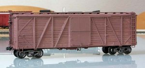

Yesterday I painted the car. I tried not to give it a solid coat of paint to make the paint look worn and faded. This led me to change my mind concerning decals. I want to use some Woodland Scenics dry transfer decals instead of Microscale decals now. To use Microscale decals means two more coats of clear paint. I fear it would make the wooden sides look like they were made of plastic.

Wow!!! That is absolutely awe-inspiring. Great work. :thumb: I agree with your paint theory, too much is not a good thing.
Looks very, very well!!!
I'm very impressed to get such an excellent looking model with a relatively small work. Congratulation again!

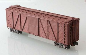

Thank you for your nice words. Jim, I gave it a light coat of paint using my airbrush, then I diluted the paint even more and applied it with a paintbrush. Here is another pic, I hope it is not getting too boring.

That is truly an impressive car. I know that took a lot of patience (not to mention steady hands!). I love to see the step by step process involved. It takes the mystery out of it and is a great learning experience. Thank You. This contest...IS A WINNER!

Just to reassure you of the paint, I found my oldest Model Railroader (Feb 1946, when it was called The Model Railroader), and it had paint schemes for Wabash... Here is the paint scheme for all freight cars, except gondolas (black) and hoppers (also black):
Metal Ends: Oxide Red
Wood Ends: Oxide Red
Sides: Oxide Red
Doors: Oxide Red
Truck frames: Oxide Red
Underside: Oxide Red
I kid you not - that's how it was listed ;)
Hope that helps.

Thank you for your nice words once again. I started this as an attempt to see, if it is possible to scratch build a decent freight car and how it would turn out compared to production rolling stock. I must admit, it looks much better than I expected and I don’t like my Accurail wood bocars as much as I did before. Fortunately the part I like least (painting), turned out to be very easy, simply oxide red. Andrew, thank you very much for your help. It’s good to know that I got it right.
