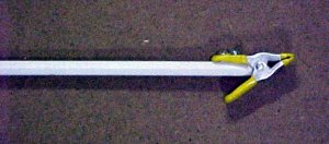

Gauge member Rory Glasgow posted a thread earlier about the headaches of maintaining track in tunnels...
Since I have a couple of tunnels on my new layout, I decided to try a variation of an idea I saw in MR mag. a few years back...
I got these little clamps at a flea mkt recently, thinking I might find a use for them, & I just did! :)
I tool one of those plastic sticks off an old mini-blind, & screwed the clamp to the end of it with a couple of small sheet metal screws...

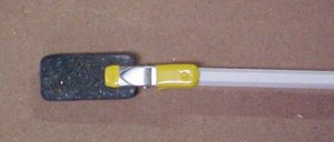

...now this will hold one of those abrasive track cleaning blocks...

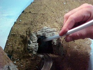

...and I can reach waaay into those pesky tunnels to clean the track!
