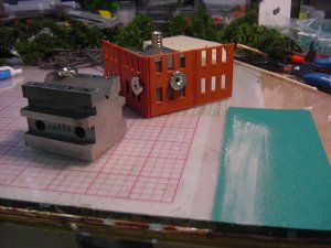

Bill Pontin
Oct 14, 2001
708
83
Milford, CT
Paul this picture is staged so I could show you the method I use. To ensure the corners of the building walls are square and level I work on a piece of 1/4 inch plate glass. I like this work surface because it will ensure your building will sit flat. In addition the surface can be cleaned easily of excess glue and paint with a single edge razor. Below the glass I have a piece of graph paper. I find this gives me a good visual reference. To hold the building walls I use several sizes of tool maker vises. The ones I am using I found at a flea market. The "rare earth" circular magnets shown, I purchased I believe at Radio Shack. Rare earth magnets are very strong and hold much better than the cast ones. Notice the green piece of sandpaper on the right. This is a adhesive back strip that I stick onto the glass to sand the edges of the building walls. Wears out - peel it off and replace it. The plate glass work surface is also very forgiving if you accidently glue a section of the wall to it. Little proding with a razor and it breaks free.
