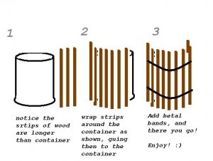

To make it sturdier, you can build it around a cylindricial container, or something of a definite round shape, make it smaller than the strips of wood, paint it black and there you go!

Miles, the shape of your cylindrical container makes me think of a thread spool - they come in many shapes and are usually discarded by our seamstress cohorts so I bet they're in large supply for projects such as this. If you can't find one just right start with one that's too small and wrap paper around it until it's the correct diameter.

I think Miles' idea is the one to go for, although instead of wood I'd wrap the Bic pen section in brown kraft paper (like on grocery bags). Either strips of paper, as in Miles drawing, or possible vertical lines drawn in ink if you don't want to mess around with really small detail work. You could use thin strips of black cardstock to do the barrel hoops and then weather everything (possibly an alcohol and ink solution, dark at the bottom and then lighter towards the top, representing years of liquid leaching into the wood). Properly weathered, I'd think this would look good from a foot away or more.

I would use a smooth pen barrel cut to length. I'd then scribe its sides vertically with the point of a knife deep enough to notice but not so as to weaken the tube. I wouldn't worry about wood grain on something so small, the paint should take care of that. Then I'd wrap it with a couple bands of fine wire. If the walls were too thick, I would place the point of an Xacto blade into the top and carefully ream it out 'til it appeared thin enough.

This sounds like a pretty good idea to me. If you wanted wood grain you could rough it up (in the direction of the grain of course) with some 50 grit sandpaper. Once painted in a base color (white), it can then be given a wash of (black) paint which will sink into the grain - wiped off with a cloth across the grain you're left with an aged wood effect.
