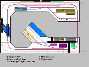

This is my layout plan, please post what you think. The two arrows go to a 10 x 10 room with 12 track staging.
Please let me know what I should get rid of or put in. All comments are welcome. I know it is poor quality but you should get the idea and objective of the layout.
CVR
Scale: HO
Grid: 40 pixels = 1 foot (12 inch grid) 1 square = 1 foot
Loco: Modern Diesels
Era: 1980 to Present
For more info check out my website at http://www.catskillvalleyrr.cjb.net
And also, I love these railroad forums, I am a member of three now (Gauge, Railroad Forum.com, and AtlasRR) and you guys are just so friendly compared to all the paintball forums I am a part of, they are all flamers who are immature.
Let me know what you think. I want responses.

Tyson - correct the door is on the right side, and then I have three unobstructed walls besides 2 small window wells at the top which will not get in the way.
Actually as soon as I am done typing this I am gonna go lay my mainline track.

Here is a rough drawing for you:

I liked your basic benchwork so there is no change made to it. The main changes to the track is dropping the second track on the duckunder (couldn't see any real purpose for it and the narrower the duckunder the better :D ), some minor changes on the penisular and cutting off the connection at the bottom between the branch and the main. Also by the time period you are in roundhouses were torn down (which is good is it wastes alot of space). I see a mountain covering both tracks in the lower left but only the outside track in the upper left. All trains coming out of staging would interchange with you R.R. at the town at the top only. Your loco (GP-9 or RS-3 would be good) would switch the yard and make the run to the town at the bottom. I wouldn't use the duckunder for reg. ops, just when I wanted to let a train run or break in a new loco. Being as we now have a port let's assume trains coming out of staging at the top are southbound, trains in the other staging yard are northbound. I would put 4 staging tracks in each yard. You could have identical Amtraks in each yard so the southbound comes thru in the moring, north in the afternoon (course you could use one and walk into the next room and turn it by hand). I would stage a southbound auto rack train (high priorty- runs straight thru no stops) and a north bound perisables (veggies for example, also high priorty no stops). Then one north and one south mixed frieght that would stop at the town at the top for set-outs and pick-ups for your train. All this is just a suggestion of course and there are others here that can probably give you even better ideas but hopefully you will find something of use in all this. I work in N not HO so I'm not sure but even though this is less track then your orginal plan it may still crowd the scenery, then maybe not :D . Whatever you do good luck and keep us posted with your progress!

CVR
Few things, you are right about the turntable, it doesn't fit the time period, but by preference I love they why they look on a layout. I have a Walthers Roundhouse built right now, but without have a turntable it will simplify a few things (wiring, buying a nice turntable save some cash, and fitting one on the layout). I don't like the crossover in the staging yard, that I will take out in the redraw I am doing now. But I love the water on the peninsula so I am keeping that, and on the peninsula instead of a warehouse, I want to keep the engine house. Also I want the left end of the layout to be like a viewblock so when you walk in you see the mountains at the far end. I want to hide both tracks on both sides and have them just show with the double track bridge. I like how you have the mainline not connecting with the second line on the bottom portion. I am sticking with that. Also I probably won't do any passenger service on this layout, it just doesn't interest me, I am a freight guy. I think that is about it, I added my redraw on here. Check it out and tell me what you think.

Pat......I see you guys have worked out a great layout. Are you going to have some dockside type activity on your penninsula water area?

Well with the water on the peninsula that gives me a lot of options. And the errors on the website are odd, it is basic html, just text, pics, links. Nothin fancy, I just wanted a site so people could see my progress. I wonder why it doesn't work, maybe because of your browser settings.

Pat, You are over optimistic on how many turnouts you can fit on your yard ladder. Allow one foot for each turnout in a ladder. You have drawn 7 turnouts in 2 feet, that just isn't going to happen!
CVR
I know it is a little optimistic, I am going to try to fit all 6 staging tracks, if not my goal is 4. I may extend the benchwork in that corner to make all 6 fit. See if I used RTS, I would know whether or not they would fit, but I am using pbrush to get my rough and general idea. I definitely won't be following that plan down to each track and grid line. I will add track and remove it accordingly as I lay track.
