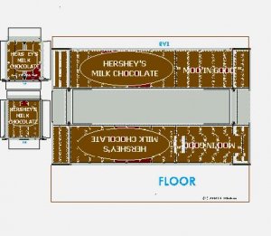

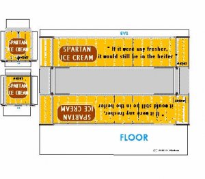

1. What do you print them on ? Plain paper or cardstock?
2. Is there a way to modify the template in order to attach the
ends to the body ?
3. Where do you guys get the logo's like UPS and others?
Here is one I designed. Hope this is right.
