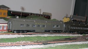

Again, excellent work -- you're really inspiring me! The layout/background looks good too.
Here are my two Santa Fe coaches -- would this kind of coaches have been used by CN? that is, would it be historically accurate to repaint these as CN coaches?
Thanks!

Rob, the Shorter of the two looks like an Athearn and the longer looks like a con-cor or riverossi. The Athearn car isn't a coach, I'm not sure what it is, maybe a dinner of sleeper, the second is a coach and I'd figure it's close enough to a CN coach that I'd paint it that way. In fact I'd paint both of them in CN but I'm not that big of a rivet counter either.

Rob, I think that both of those cars are Athearns - the one with the irregular windows is a diner, while the other is a coach. The CNR had a roster of almost 15,000 passenger cars, and while it's unlikely that any were exact matches for the Athearn cars (which are abbreviated to allow operation on smaller radii), this is where you use your modeller's licence. I doubt that those cars are dead-on for Santa Fe, either.;):-D:-D

Thanks, Glen and Wayne. Yes, the first car is a dining car and I think at least one is an Athearn. I know I made one from an old kit. So it sounds "OK" to proceed with painting them in CN colours? This should make for an interesting project in the near future. Thanks, Rob

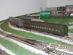

I finished the train, with a few exceptions that I'll add later:
P2K FA-1. Okay, so it's not a real passenger engine but I do have a 4-8-2 steamer that I'll be working on to replace it.
the finished juneco express Reefer. I added the trucks, couplers and door hardware today.
Mail and express. I messed up on this and the diner car. the wafer is tilted in the wrong direction (DOH!) I don't think I'll change to though since both cars match and they won't be leaving my home layout.
Coach
Dinner
Observation
There are a few more things to add. I have been toying with the idea of adding limited interiors to the cars. I also have to add diaphrams when I track some down.
I do have a lighted drumhead for the end on the observation car, I might also repaint the railings on the observation car, I'm not too happy with the CNR yellow. I think the real ones had brass.
Finaaly I also have a through baggage boxcar on the workbench, waiting for decals.
