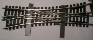

The answer is "yes" - but it depends what you want to do with it! This is a pair of small radius LH switches cut down to make an interlaced switch, for my new layout
