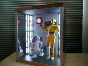

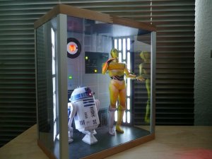

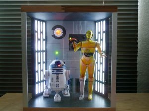

    Here is my latest Diorama:
    R2-D2 and C3PO at the Death Star, trying to shut down the garbage compactor beneath the Detention Block.
    This is my first Diorama with lighting.
    Regards Loenf

    Now that is sweet! Very well done.

    Wow! That is impressive, indeed.

    What can I say but amazing!
    I have also made this R2-D2, but yours, combined with the diorama and the magnificent C3PO...it is truly a masterpiece.

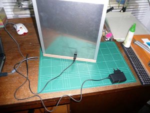

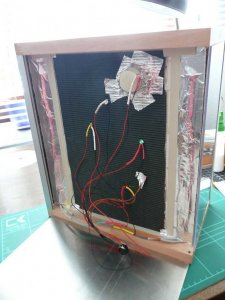

    Hello,
    yes, it is the C3PO from UHU,. The R2-D2 is from the following link:
    http://www7a.biglobe.ne.jp/~sf-papercraft/Gallery/r2d2/r2d2.html
    The R2-D2 modell is nearly the same size, so you donĀ“t have to rezize it.

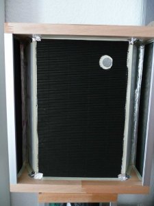

    Here are some pictures from assembling the diorama. The background is illuminated by LEDs in differend coulors. The current source is an old batterycharger from an old cellphone.
    regards Loenf

    Thanks for the details. The use of the old cellphone charger is an economical idea.

    Amazing. Good to see the rear of the model as well. The lights are a great addition.

    That's a brilliant/brilliant diorama loenf. Yes, it really is. :wave7:
    Thanks for showing the pictures from behind also.

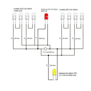

    Any chance you could give an electrical schematic? I am sure many of us would appreciate it, I certainly would.
    Many thanks for the post.

    Hi,
    here is an sketch of the LED circuit of the Diorama.
    Here is a very usefull Current Limiting Resistor Calculator for Leds
    All the LEDs are parallel connected to the current source. With different resistors you can change the luminance of the LEDS.
    Regards Loenf

    Thanks for the schematic Loenf.
    The lighting really makes the diorama come to life.
