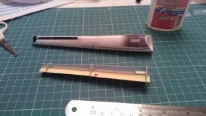

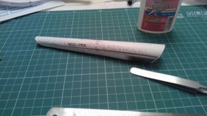

Hello,
I have finished assembling the starboard (hence the title) nacelle's body, and it was not so hard. I guess the hard part comes now!
First things first:
1 - DO pre-shape the body, it will make your work A WHOLE LOT easier;
2 - I cut off the tabs from part of the "bones", but left the ones in the small, rounded ones - but I have compensated it with large ammounts of glue in pieces B-1 and B-2 (#S-34 and #S-35, respectively);
3 - to know how deep the "bones" have to be pushed into the nacelle's body, apply the same rule that we used in the body, which means, align the first rounded shapes (pieces #S-24 and #S-25) to the seam between pieces #63 and #64;
4 - you DO NOT need to laminate these skeleton pieces, because the great master UHU02 already prepared a double set of each. All you have to do is glue one another, and they're laminated AND reinforced. Simple as that.
Here are the pics:

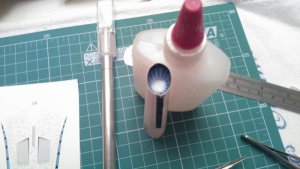

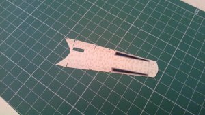

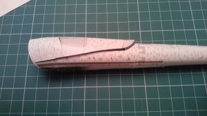

Hi,

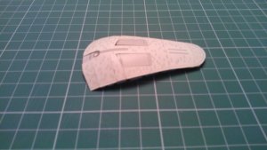

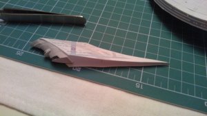

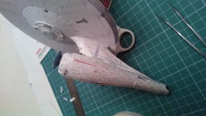

Assembling the front top of the nacelle (piece #61) was a test of patience AND skill. Not that I'm so skilled, but it almost made me give up a few times, and wait until tomorrow to restart. On the other hand, finishing it was a tremendous feeling of accomplishment.
The first difficulty is that it bends in two orthogonal directions, so you have to take your time to assemble it. And DO take time, SPECIALLY if you want to do it without tabs -second and always present difficulty.
SUGGESTION: assemble it from back to front, and the reason for it is quite obvious... smaller to bigger curvature, or, if you want, the curvature radius become smaller, meaning its rate will turn higher, making it harder to assemble. Glue piece #60 AFTER you've finished #60; worked best for me that way.
To glue it to the nacelle, I found it easier to attach first the front part, then the back, then the sides, ONE AT A TIME. Pay attention to the angle between the thin black stip and the nacelle itself; the strip has to be orthogonal to the nacelle surface. I did an almost adequate job on that.
Here are the photos:
1 - the first photo shows pieces #60 and #61 assembled together;
2 - the second shows the back of the set, with some paper reinforcements to hold for the tension (I thought paper scrap reinforcements would hold better once they were glued); and
3 - the last one shows them already glued to the nacelle.

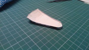

And now we can see the front bottom piece (#68 ) both before and after being glued to the nacelle. The best thing to assemble it is just like the post about piece #60, EXCEPT that you should do the front for last. So, glue first the back, then the sides, from back to front (the front edge isn't actually glued, it's an "inlet").
If the slots do not look aligned, but you're sure you've glued it to the right place, do not worry. When the support piece come into place, it will correctly form piece #68 and align. That's the beauty of a UHU02 :inw: model!
