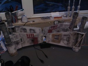

in the meanwhile i finished the first gun....AND DAMN...i hope i the 4th gun looks like the same as the first :mrgreen: (its really difficult for me)

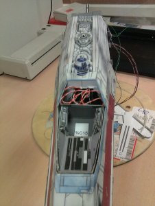

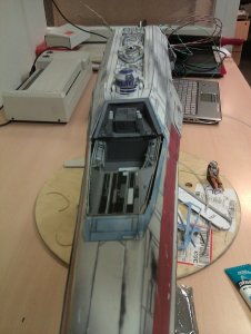

today all Leds are running in the cockpit..
but the next problem is...it doesn't fit in the fuselage..
so i have to cut some space in one of the ribs...
That idea of Zathros wasn't that bad :)
I should start to listen to other people then this would be easy :)

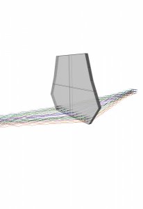

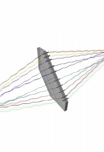

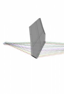

It looks like you can cut the back fuselage former and stuff them in there, This is what I thought was going to happen. I used to have friends that made harnesses for every helicopter Sikorsky made,. They would lay the harness on a full sized board that had the full outline of the helicopter with areas coded represented solid walls, holes, etc., so they would know how the harness was going to look, and where to have disconnects. The wiring looks like it could be significantly reduced by using the micro crimp connectors. This would essentially have all the power leads to thee covered LED bulbs terminate at the firewall behind the seat. You could actually make that panel a board to plug the power leads into by making it an electronics panels such that if any repairs are needed, you mere pull a wire out of a hole and replace whatever may be necessary.
I attached a drawing to try and explain what I mean. It's not to scale, or the right shape, a represenatation, but it conveys the idea. It's kind of a panel box, without the box. Tinning the wire ends with solder would allow them to act as pins you would insert into the connectors. I would solder the power side into the pins. 1MM card stock and some crazy glue will hold the pins in place (plus a tight hole). This would allow you to place the wires flush against the fuselage. and the LED's inside the nose, or wherever is necessary.
Just a suggestion. It adds a lot of work though. Nothing more than a suggestion that popped into my head. :)

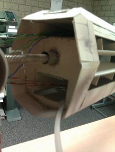

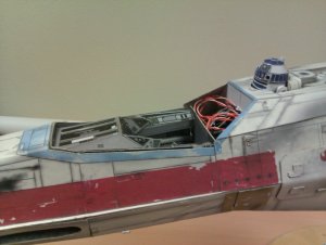

YES it's in.
Tomorrow i need to take my laptop for testing the light....i hope they survived the installing :)
Then i can glue the cockpit in his final place..
YES
