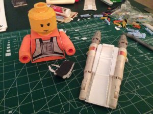

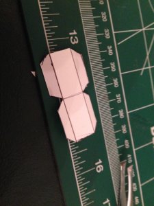

Okay, I came back to the model after a little hiatus, both to clear my mind of the frustration of that danged forward sponson piece, and to start building another model as a present for a friend (it's in the picture below, still in progress).
I decided to build the part anew, to make sure to pre-curve it, and to make the glue tabs twice as wide. I also put the glue on the body section, rather than the glue tab. And I held it in place for a long, long time. I don't know which of those helped the most, but the sponson piece is FINALLY in place, and I can move forward on this ship. PHEW!

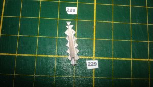

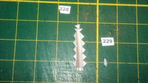

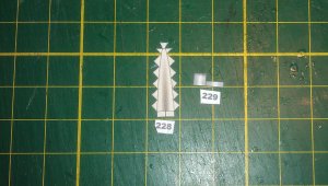

Assembling these parts are quite easy and straight forward.
Wrap part 229 (TIGHTLY) around a thin needle or pin.
With part 228, bend the tabs back, then roll the center section (into a semi-circle).
Glue part 229 into the space at the end of 228 (as shown).
I hope this will help.

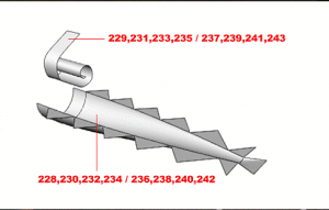

Look closely at the instructions, you will see how part 229 is rolled tightly around itself.
I know that is shows the thin part of 229 still flat, but continue to roll it completely around, so that it looks like the pictures that I posted earlier.

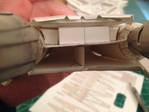

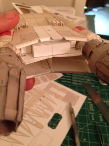

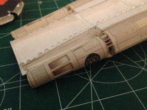

Slowly but surely, or at least slowly, I am still building this model! :)
My job got really hectic around the end of September, and so not a lot of work has been done. But here's where I am right now... the dorsal and ventral skin of the fighter have been completely attached, as well as the forward weapons cones. I was finding that the aft ventral compartment kept wanting to become concave with the slightest pressure, so I built a little brace to reinforce the interior space.
I am working on the forward ventral pieces now that allow for the footwell and landing gear.
Plugging away...

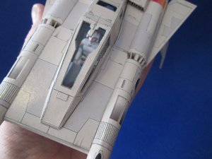

Sorry to comment late in this. When I do the nosecones, I start by gently rolling them with a round file against my leg as a work surface. As it starts to curl, I use a bit more pressure, repeating until one edge rolls over the other. Since the part is sort of an arc, you have to follow the arc as you roll. Eventually, you'll be able to 'over roll' it really tight, then the edges can match up and you can glue it. Don't cut out the cannon ports until the nose cone is glued, then use a tapered dowel for support inside it, and then cut the holes out with a fresh blade. The biggest problem I had was the tiny cannon barrels themselves, so after many failed attempts, I now use round tooth picks painted black instead. Hope this helps! Here's how they look, with painted carved dowels for the tips too.IMG_3468.JPG

Thank you both! I didn't have a close-up of the nosecones so I used this pic instead. Part 229 and I just can't get along, so I use the painted tooth pic sections for the cannons - Hopefully this tip will help someone out! And, if you glue them to the inside blast tube before you insert it into the nosecone, it makes it a bit easier to handle and locate. Coloring the barrel with a sharpie, and rubbing over it with pencil graphite gives it a nice gunmetal look too.

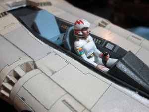

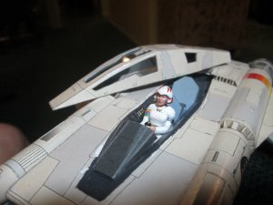

Thanks Crimson! No, she's a resin casting of a figure i sculpted originally for the old Monogram Starfighter. Had a few casts laying around, so in she went! If you don't mind, here are a couple of pics.......By the way, the cockpit add on that RF and RB created is amazing! Thanks for that, guys! I had to hack it up a bit because my figure was a bit too big for it, but it worked great in the end. I really love the Thunderfighter, and this kit and it's add-ons is very special:)
View attachment 137860 View attachment 137861 View attachment 137862
You did a GREAT JOB with the figurine. She looks FANTASTIC!!!
However, it you are interested in a (EDD Pilot) paper figurine, you can find it here: http://tcfgaming.com/.
Just to let you know, there is a detail (screen accurate) version of the cockpit interior now available on Martin's site.
