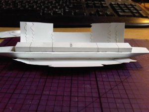

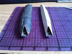

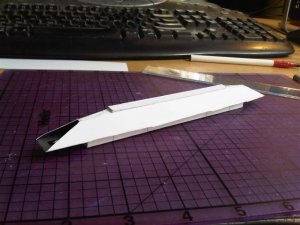

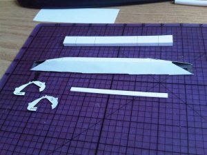

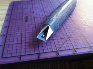

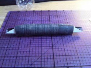

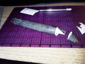

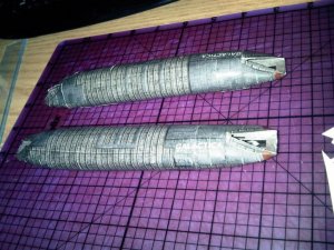

Finally got the 2 landing bay pods done.. they were a total pain. I could not get the formers to work that were supposed to be used. I ended up laminating a beam and gluing it to the top.

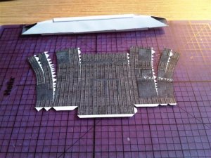

Here's the method I ended up using to make the bays. Form inner piece, laminate beam on top. I then cut the ends off the outer shell part, and formed the center and attached. The end pieces I formed separately and attached last. Next I finally get to attach the pods to the retractable beams.

Wow, very nice! Thanks for doing this. I have the 1.5 in mind as well but no time to do it for a while, and you're paving the way and pointing out all the issues I'll keep a wary eye on!
One thing I notice, though.....
Are you sure those "lips" around the glowing exhaust ports weren't supposed to recess inwards? I got that impression when poring over the printout sheets.
